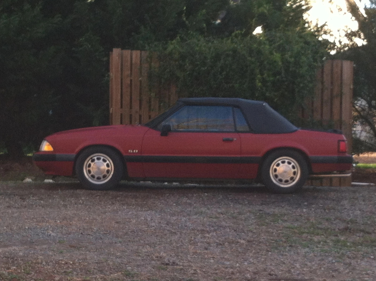

i have eibach pro springs. drop is just right imo. i also run kyb gas adjust shocks. the kyb give it a pretty stiff ride but i like it, handles well and is really tight.
front well lip 24 3/4
rear well lip 26
please excuse cr*ppy cell phone pic
