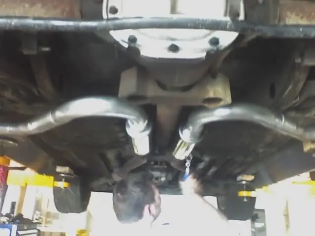

I ran side pipes on my 1998 car. I used thin flowmaster mufflers(not sure if they make them anymore) and had a mustang shop custom fit y pipes with dual tips on each side. There are also some mufflers that you can buy that have the inlet and outlet on the same side, so that you can keep your mufflers in the stock spot. However, I don't think this is the best thing for power, as the exhaust has to bend quite a few times.

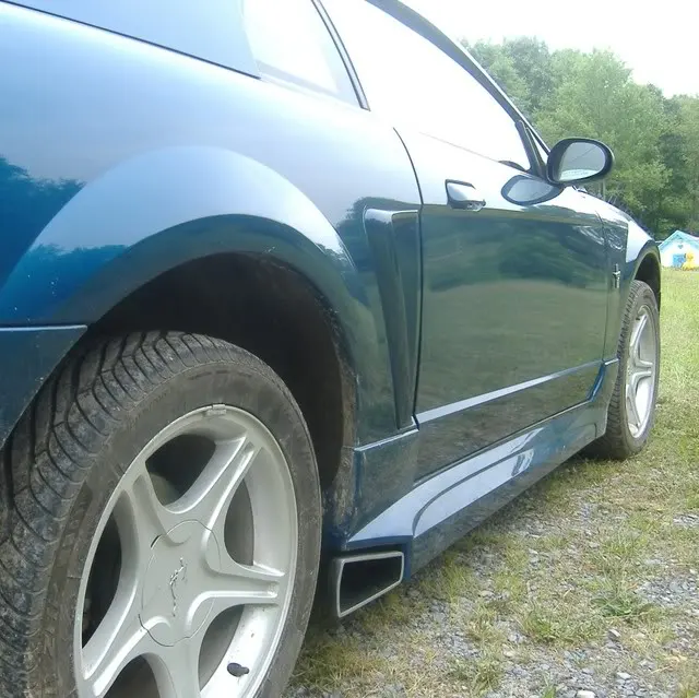

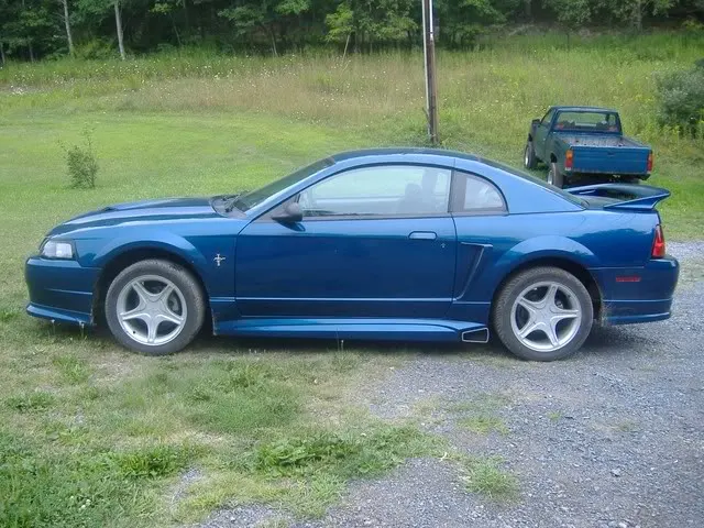

I had a Roush Stage 3 kit and side exhaust on my first stang, 2000 GT. I got MagnaPacks and custom bent my exhaust. Sounded awesome, MagnaPacks sound great with side exhaust.
yea thats what my buddies were saying yesterday that for the 94-98 they made this cover for the gas tank and the sorrounding area so it didnt look weird once the exhaust was removed. i love the way the svo side skirts with the exhaust look on the 94-98

You don't have to to even have a 90 degree bend, if I remember correctly. On my car, I would guess that it was a 30-50 degree bend strait after the H pipe. The flowmasters I ran were about half as tall in terms of height, but the overall size was similar. The inlet and outlet were on different sides. So the mufflers were relocated. I'm sure a small bullet style muffler would do the same thing. You just really have to worry about scraping, as mine would still scrape a bit. If you keep the mufflers in the stock space, you have to run a muffler with the inlet and outlet on the same side to make the bend.
