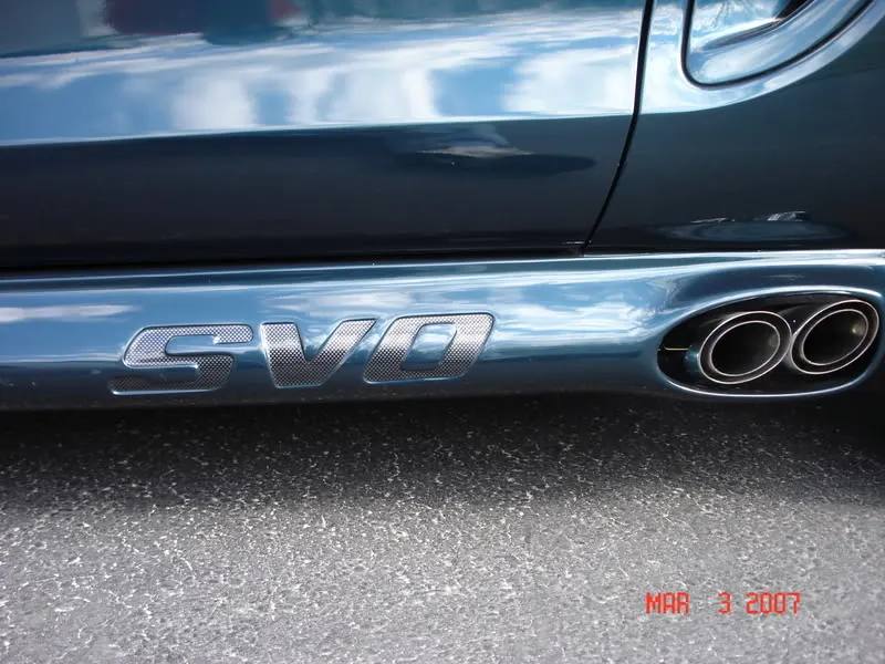

I've messed up mine a few times, once ripped it right off the car in half right before the SVO. Yes, the originals are fiberglass. We mat & glassed the backside and on the exposed side we ground out the cracked areas making a channel for glass resin then bondo'd. Sanded and repainted. Had them on for past 11yrs and still going strong.
