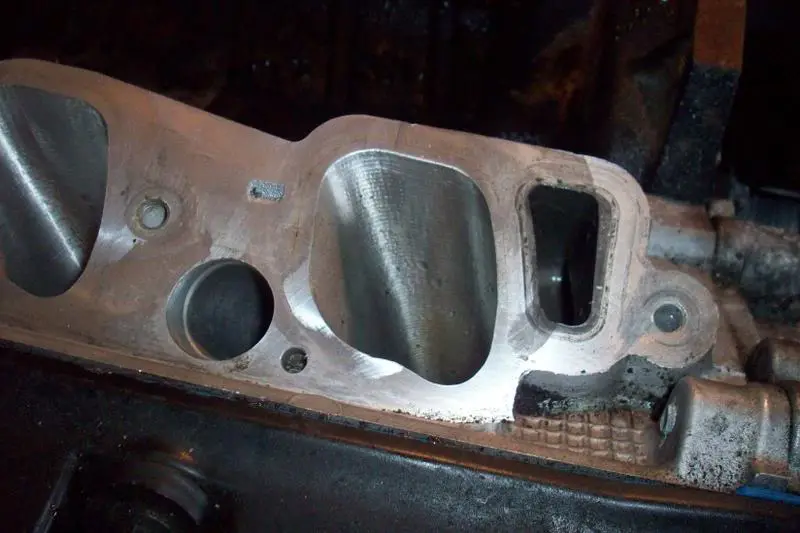

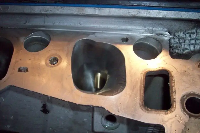

Did you clean the intake of all the oil residue? When I changed my heads my ports looked like that and the piston tops had a nice coating also. Then I eliminated the pcv set up and when I changed the intake this last time the ports where spotless.
No, we just slapped that joker in place. We were looking to get it done before this past Saturday so kinda under the gun. I'll be pulling it back down in about 6 months or so to forge the bottom end and put some ported/polished heads with blower cams on it. I'll go through everything with a fine comb then cause I'll be looking for everything I can get power wise. I'll probably switch to a ported Eaton then too (until I save enough for the Whipple 3.4)...

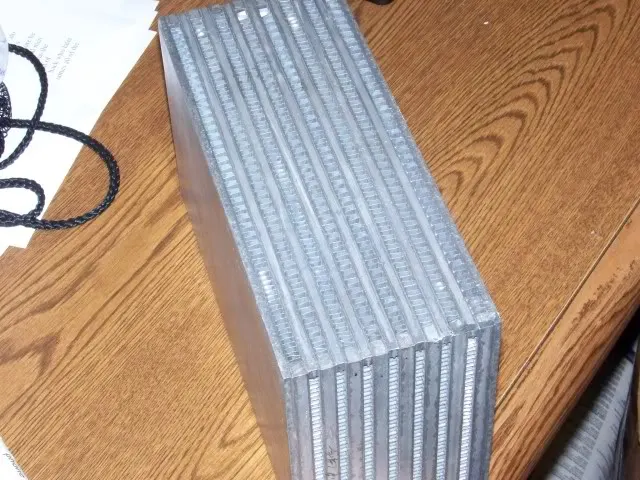

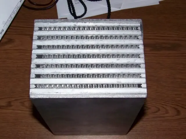

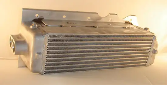

To my knowledge, this (pictured below) is what they refer to with their "Intercooler Core" as advertised for the supercharger-less kits on their site... This chunk of finned aluminum (core) with no end tanks leaves final fabrication to the buyer which in this case is or can be very expensive (even cost prohibitive to the project). Also, this is all that you can use as it's all that fits into the basket. I was half asleep last night when I called it a single pass core, which was a mistake, because like any core, it can be made however you wish with the right tank design.
My point though is this, to use their supercharge-less kit, you’ve got to do something for the end tanks and then do something for the mounting bracketry, you’re then married to that TTI core (or similar core) if anything ever goes bad. Who knows where they will be 2 years from now (especially with the economy). This is the reason I decided to redesign for the Cobra IC (also below). I wanted everything to be replaceable with commonly available parts, and nothing proprietary or nothing that would possibly have to be fabricated or re-fabricated down the road. This will keep the resale value of the manifold better because it's not dependant on whether or not you can get an IC core to work with it, and the end result (manifold / intercooler design) is standardized instead of each pair potentially being a custom design.
