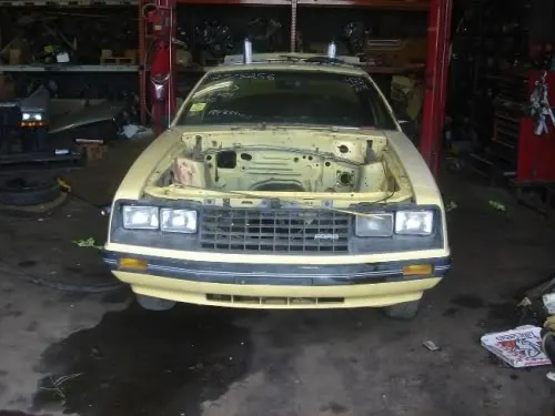

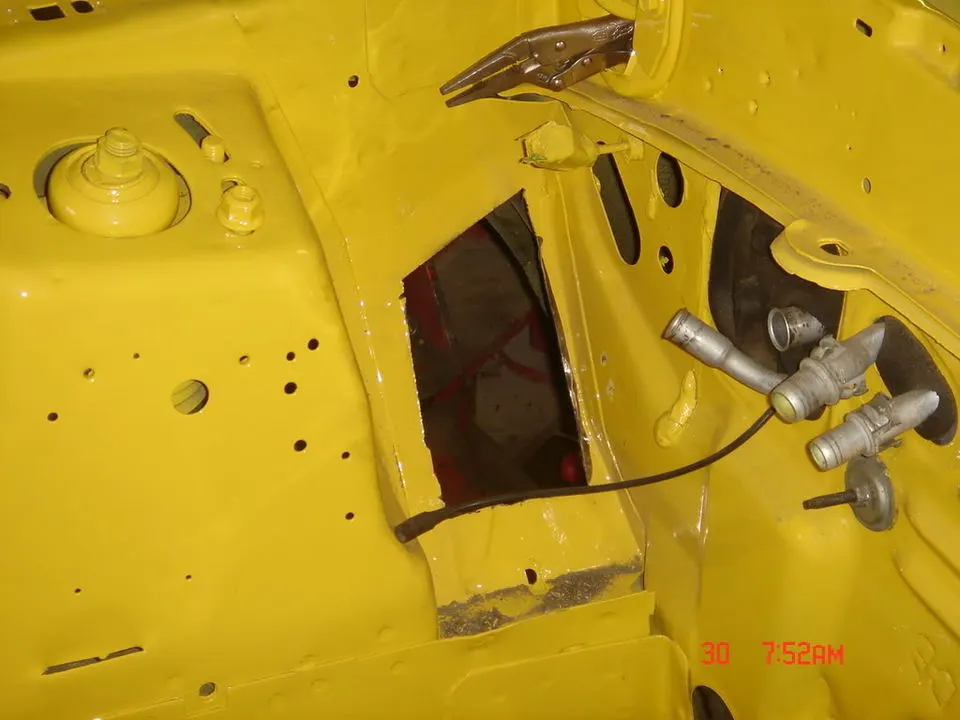

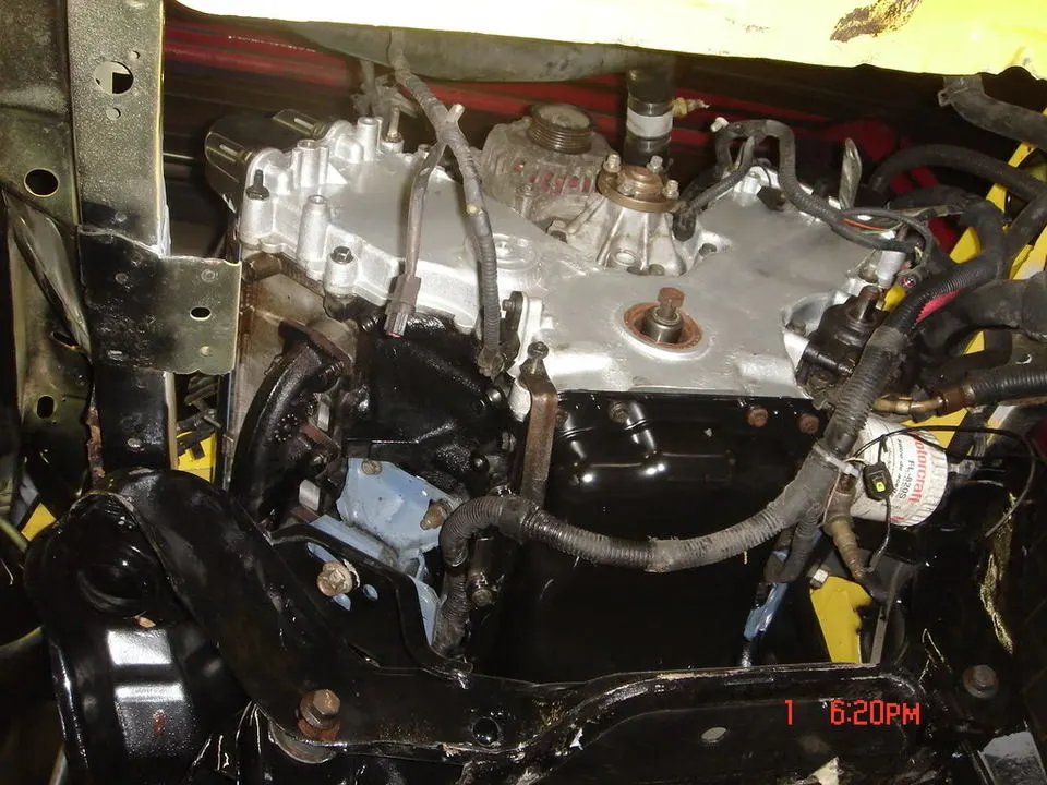

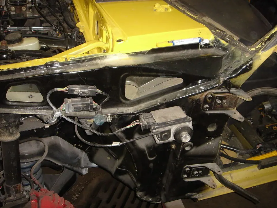

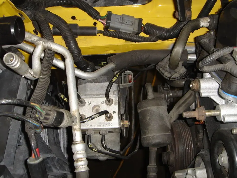

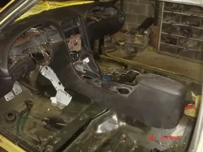

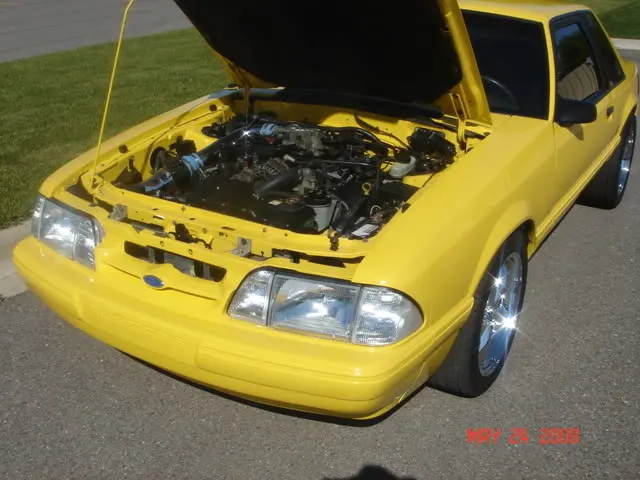

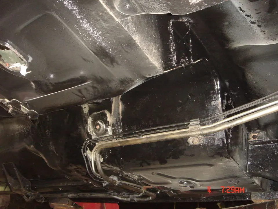

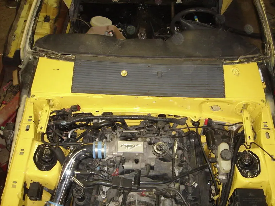

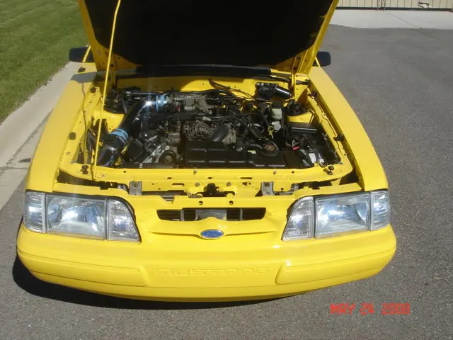

I put a 2001 4.6L motor, trans, ECM, dash, ENTIRE HARNESS from headlights to tail lights, gas tank, fuel neck, fuel lines, ABS unit, brake lines...EVERYTHING from that car into my 81 notchback. You need the whole harness. In the back of the 99-04 Mustangs they have a fuel pump driver module that is tied into the harness, and without it, the fuel pump will NOT work. TONS of work, but well worth it.
Here are some pics.
11 months worth of fabrication, welding, cutting, trimming, body and paint work. Well worth it in the end.
