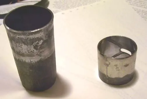

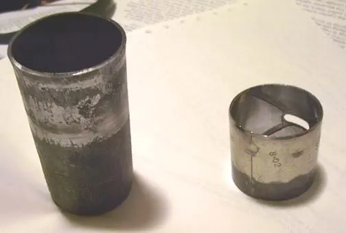

Well, I found out(sadly) that my hunch on a bad bushing was in fact correct. This is a brand new bushing out of a David Kee rebuild kit for reference:

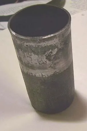

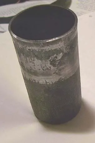

However, that hunch was only partially correct. This is what was in the trans:
In case you're wondering, that is not a tailshaft bushing of any kind. It is in fact a piece of galvanized fence post. It slid right out of the trans and revealed a big oval hole where the real bushing should have gone. My old man SOMEHOW missed this when he put a new tailshaft seal in before I got the trans. :rolleyes:
Now I have to change the whole damn tailhousing under the car and I'm pissed the F__ off about it!!! This could have been done while the trans was apart on the bench!!! :mad: :mad: :mad: :mad: :mad:

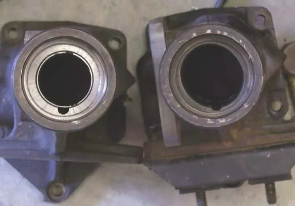

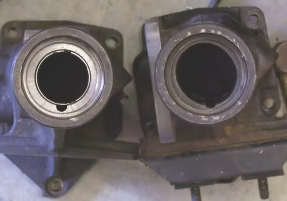

Well, here's a comparison.
I'm just not sure how to position the oil hole in the new bushing when I install it. I assume it goes down toward the oil slot, otherwise the oil wouldn't flow into it. It might not matter since the bushing I knocked out of the good housing didn't have an oil hole. :shrug:

Yeah, I saw Kee's tailhousings, but $300 isn't in the budget at the moment. I ust used the other good housing and put a new bushing and seal in it.
My dad was looking at the wallowed out housing and already has plans to fix it. All he has to do is center the housing on the seal bore, bore out the oval, and press a steel sleeve in there good and hard. More power to him.
