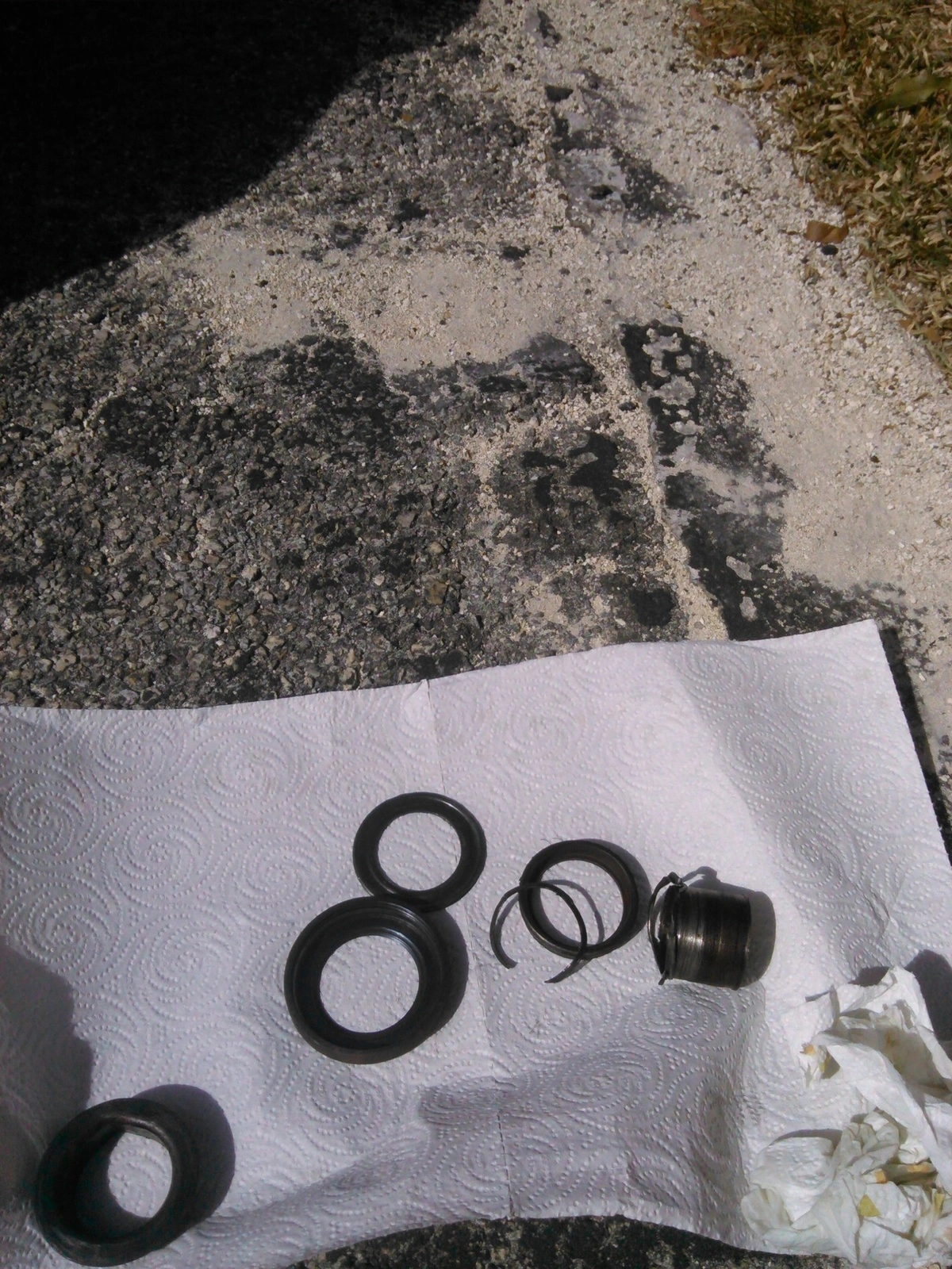

Thanks for the advise. I ended supporting the engine and used a bigrr crowbar and she separated. the throwout bearing is trashed like I thought. Thanks again.
