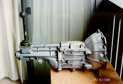

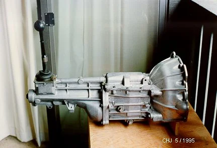

Mustang5L5 That is…until I whipped out my Bissell Mod Dude Feb 18, 2001 43,390 18,133 224 Massachusetts Mar 11, 2007 #6 Mar 11, 2007 #6 Here's a camaro T-5 Here's a Mustang T-5 View attachment 397185 Major difference is the shifter location Attachments p7mgbv8.webp 20.8 KB · Views: 170
