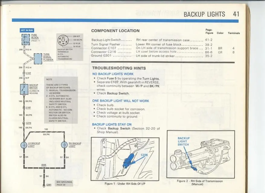

So recently I did my T-5 swap. I used parts from an 86 donar car, but the trans harness in the car was damaged and I couldn't use it. I put a jumper on the NSS so it would start, but can someone tell me which wires to connect the reverse lights?
