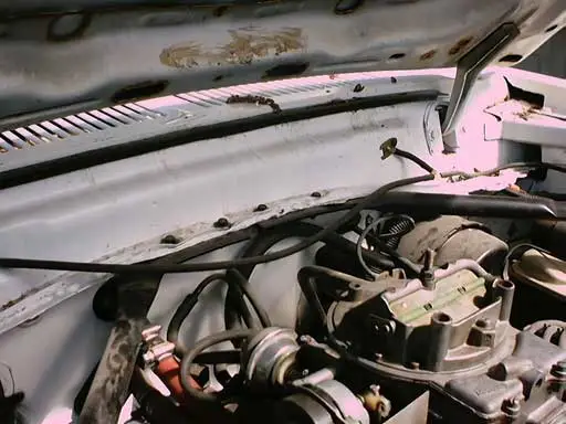

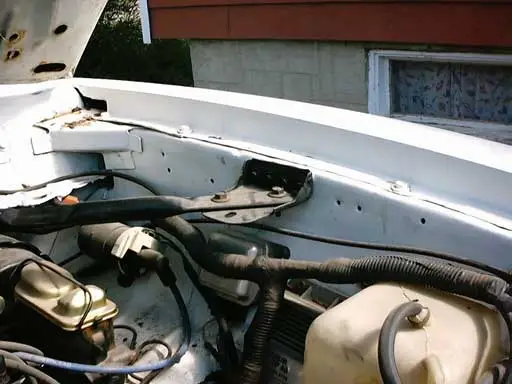

here's the drivers and passenger side mounting:

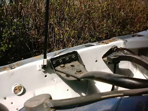

And the cowl mount:
Hardest will be finding "correct" fasteners. The ones on the cowl are 3/8" ?coarse thread (check the braces themselves to confirm) but because of limited space they have small heads with integral washer that use a 3/8" wrench. For the side brackets, IIRC they used a fine thread 3/8" bolt, again with the smaller heads.
If you need measurements, or want me to pull the bolts to confirm, let me know :)
Thanks Francis, those photos help. I was unsure how they bolted to the cowl but now I see.
How are the side brackets mounted to the fender panels? Are the fasteners sheet metal screws or are the bolts with some sort of washer/nuts on the back?
