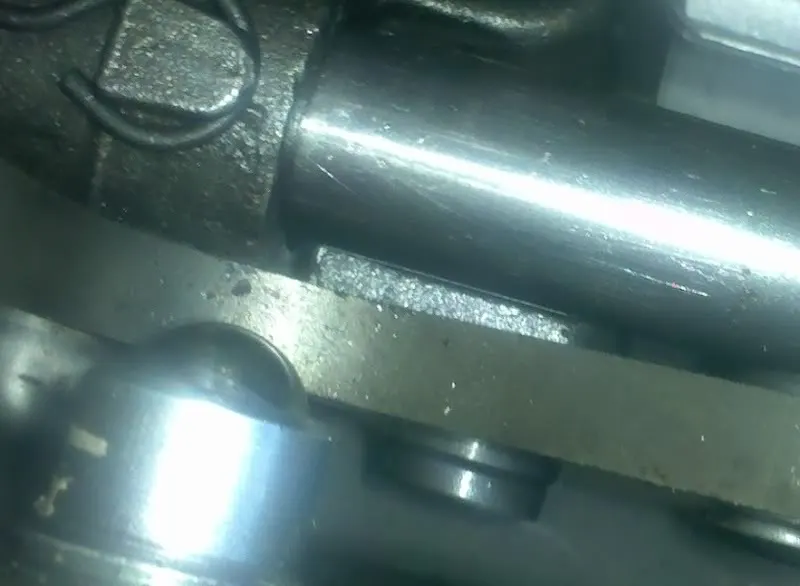

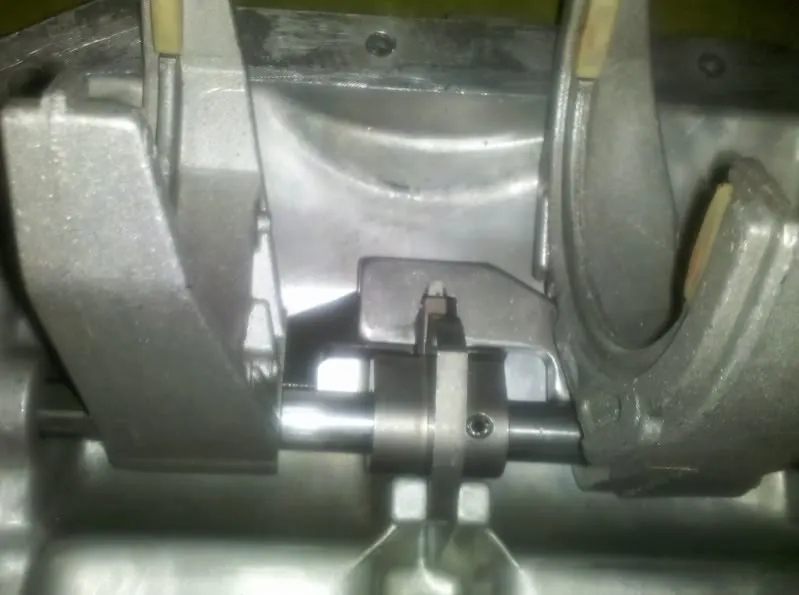

Hey guys, sorry to make another post about this, but the shift forks and the tailhousing are giving me fits. I read on another post last night to pull on the 5th gear rod a bit, and the tailhousing will drop. Well the tailhousing will find home, but it then jams the shift forks and I cant rotate the shift fork rod on the top cover to the left (looking from the tailhousing side.) When I put the shifter on, I also can't unfreeze it to gain access to the 1-2 side of shifting. If I get it back to where I can though, the tailhousing won't slide completely on. Do I have something wrong or am I just too impatient and need to mess with this more? Thanks.
Noone have any ideas? I got it to go to the 1-2 side once, but once I worked to 5th and reverse, it was back to being locked from the 1st and 2nd forks. Completely stumped, any ideas would be a tremendous help. There is this piece that looks like a snap washer goes on, can anyone commment?
I am posting on an iPhone, so it's tough for me to be detailed.
Did you touch the main cover shift linkages at all? If you did, are you 100% sure you replaced them correctly?

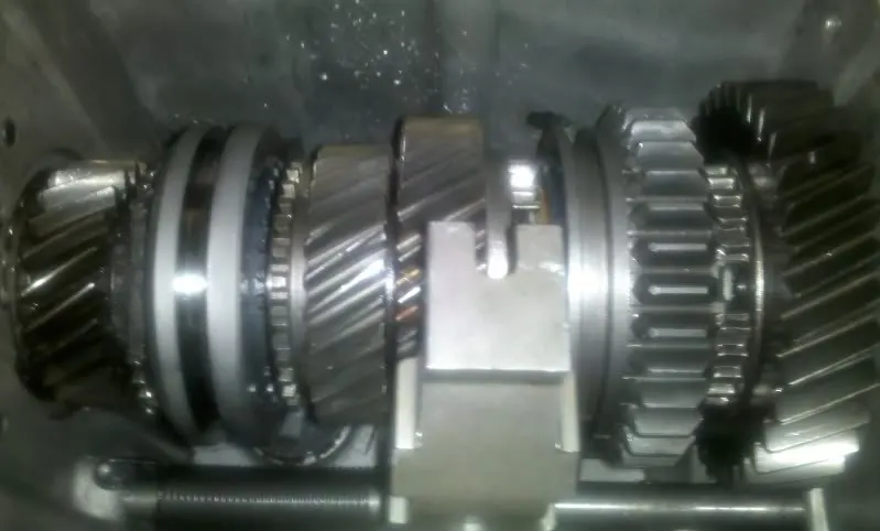

Donyou have some more pics? Specifically the underside of the top cover and how all the gears sit when in neutral?
