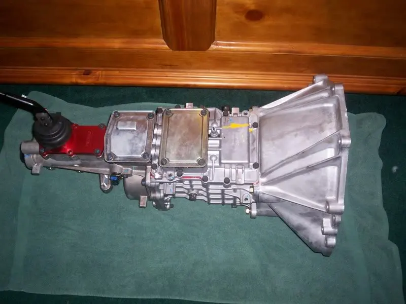

agreed clean that tranny,im doing the tko 500 swap this week into my 95 stang....
