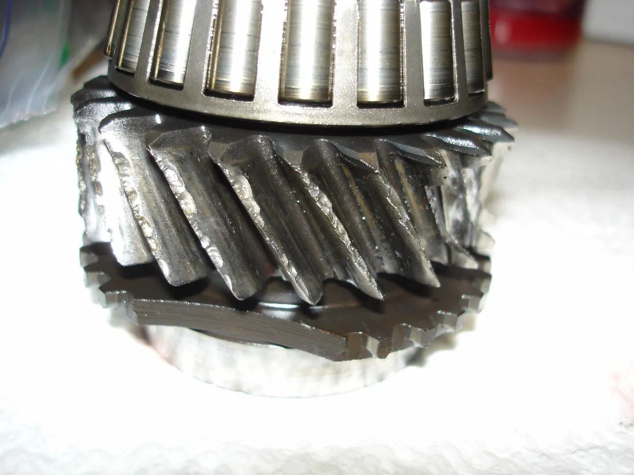

BTW, the last t-5 i tore apart that had a sort of grinding noise to it when just idling had this when i pulled the input shaft out
attachment.php

You're not going to hear a grinding noise from having play in your input. (this is assuming you have just slight average play. If you have a LOT of play, then anything goes) 5l5, that's a bad looking 4th gear. what do you think caused that?? The worst that I've seen from having too much play in the input is popping out of 2nd gear. It will cause accelerated wear of course, but it's not going to have constant low rpm noise.
No idea really. The entire trans was junk. Input shaft junk, countergear junk, 2nd and 3rd dog teeth were mashed to hell and you don't even want to know how much metal i found at the bottom stuck to the magnet. Mainshaft was scored where the input shaft roller bearings ride, so that was junk too. Basically the only usable parts are the case, 5th gear, and the shift linkage/forks and misc small parts. I got them all bagged and boxed up squirreled away
