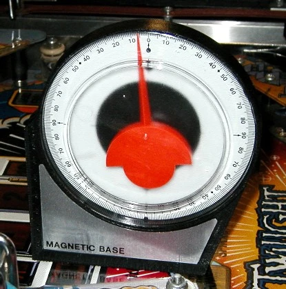

You'll need a machinist protractor or inclinometer/angle finder.
Problem with inexpensive inclinometers is they can give different readings when measuring from different directions or the other surface on the gage.
I was just having a thought, and I don't remember ever seeing anyone checking, changing or mentioning it. Is the II yoke OD the same as the T5 yoke OD? I guess where I am going with it is if there is a difference, couldn't the original vibration have been from the difference in the bushing ID and my yoke's OD? Then the sudden change could be from maybe the bushing and/or tailshaft housing cracked? Like I said, it is going to be a couple of days before I can get underneath it, so I am just speculating, but it seems to make some sense in my mind right now.
As far as measuring the angle, what I was going to do with it was get the car off the ground as level as I can, then with the driveshaft out, I was going to measure the centers of the tailshaft and axle to the ground. Trick is with either way you go, with either the angle finder or just measuring, the car has to be level. Where do you check for level-the rocker panel? That seems to make the most sense to me, but I just don't know.
:scratch:
Only way I know of that works is using a protractor head or inclinometer.
Level is irrelevant, and the suspension should be normally loaded (IE: Over a pit, on an alignment rack (or similar lifting device), rear wheels on blocks with stands under the front cross member, and so on).

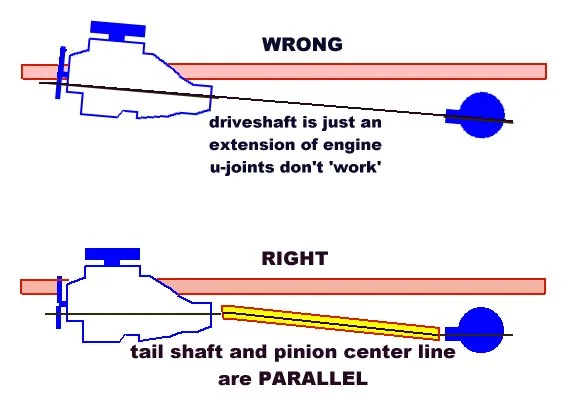

Here's a couple links to a good articles explaining it all.
DRIVE LINE PHASING

You don't need to do anything fancy. You don't even have to remove the driveline and car should be on the ground or positioned as such.
Fact is the shaft can't be measured with it out of the car.
With all due respect, Not really.
DRIVE LINE PHASING[/quote]
I've worked with drivelines and drive shafts on my cars, fleet trucks and installed equipment and the above artical left me scratching my head. The author was going back and forth between cars and trucks which are the same but different, and doesn't explain relationships, etc.
Take the following illustration:
Wrong is Right for a leaf sprung vehicle in motion at "speed", speed being ? 30-40-50-60 mph? and above ?
THe author does write this: Normally the pinion gear angle is a negative angle and the nose of the rear end is pointed down. This allows for the upward movement of the rear end when torque is applied. Those who follow racing will know the term spring wrap. Setting up a drive line for racing situations or high torque off-roading is different and much more complicated than for street vehicles, as many more variables enter into the formula.

Also, in the above illustration, both pictures are the same. In both pictures the driver (engine and trans) and driven (pinion) lie in the same plane so rotating the axle will take both systems out of phase.

When I forst looked at the illustration on this site I thought Madness , shear MADNESS!!! The shaft will rotate into knuckle city.
Then I realized it was a toy car site. And their using heims. Heim joints don't allow the axle to rotate so the driver and driven have to be set in the same plane.
Then tere is factory 4 link (sic) and the bushings allow a little play.
Leaf springs? Axle wrap is our nightmare.
I'll re read this and see where I forgot this or that, where something could have been written better ... it's not a term paper. :rlaugh:
Conclusion ...
Leaf sprung automobile drivelines are designed so the rear axle rotates into a straight line thus everything is in phase and everything is spinning at a constant velocity resulting in a nice cushy ride.
Truck drivelines, otoh, such as my Toyota 4x4, will never be in a straight line, the system is designed for the axle to rotate (sort of,) into phase. The truck will always have some vibration because the drive shaft will always have two accel/decel cycles per revolution.

1) When measuring this the cars rear suspension needs loaded as though it's sitting on the ground. The rear axle needs set on blocks or stands or the tires on blocks, the front wheels need to be on blocks or the front held by stands on the cross member (on a line between the spindles). I've had the back on blocks and the front frame rails on stands in the header area and notised when lifting from the cross member the rear pops up or down when coming off or going on the front stands.
2) as has been stated, the inexpensive inclinometers arent to be trusted, Their repeatability needs verified. IE: Mine will read 1 ~ 1 1/2+ degree different depending. IE #2, If I measure from the tail shaft of the trans and the measurement is 1 degree off true, then rotate/spin the gage 180 deg and measure the rear and it reads 1 degree off in the other direction it's actually reading 2 degrees off. :shrug:
3) Unless measuring from the machined surfaces of the yoke your probably not getting a good reading. I don't remember seeing a factory yoke with other than the cap surfaces that could be considered measure worthy. So you need to seat a set of caps in the yoke, or figure another way to measure from the machined surfaces.
I get the tail shaft angle from the front belt pulley/dampener. Luckily I have a 2' steel rule so I can drop a parallel measuring surface about 14~16" under the pulley. Any straight and parallel item of sufficient length will work.
Doing it this way I can measure from the "right" in the front and from the "right" in the back and inaccuracies in the inclinometer matter little if any.
