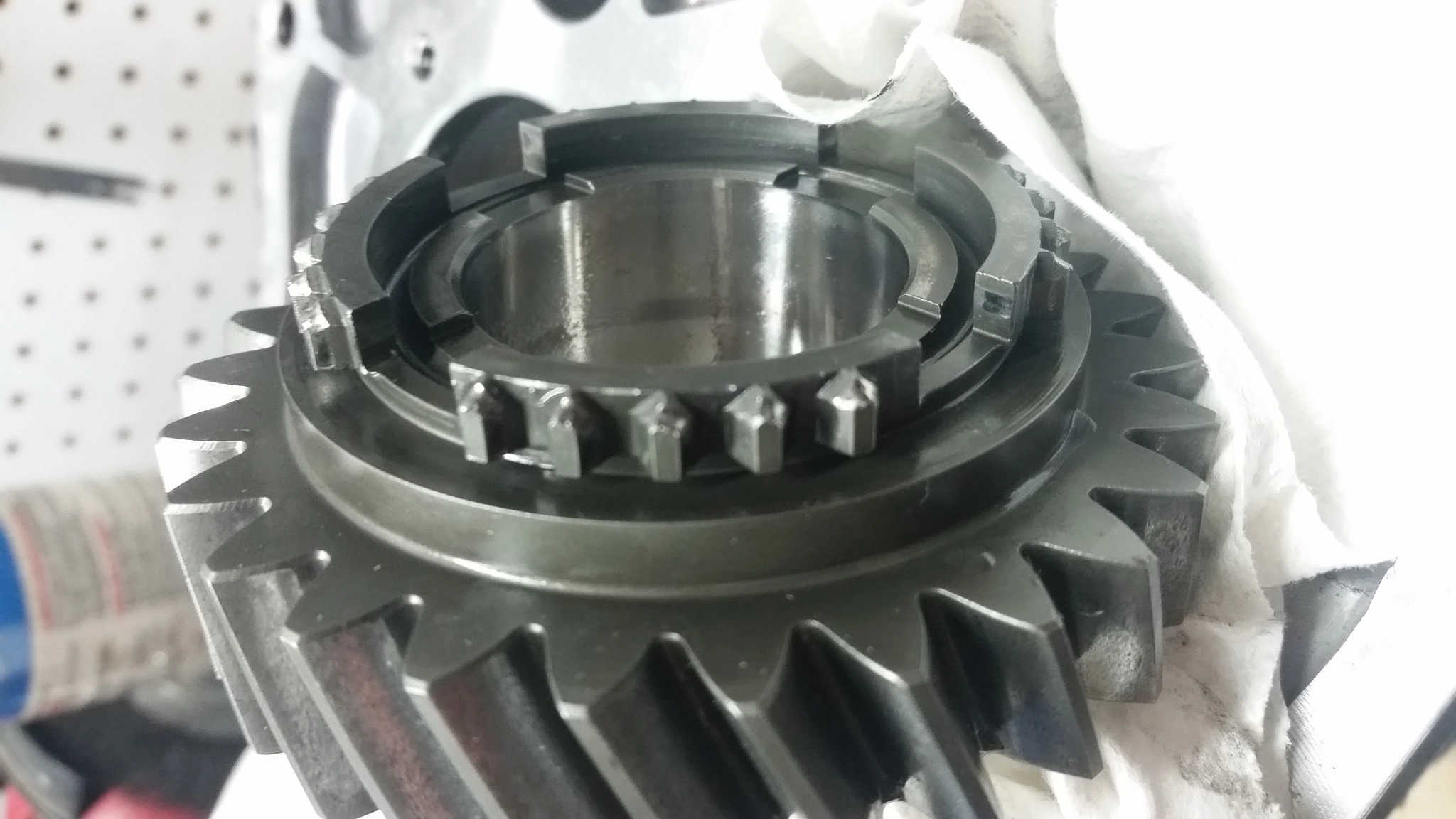

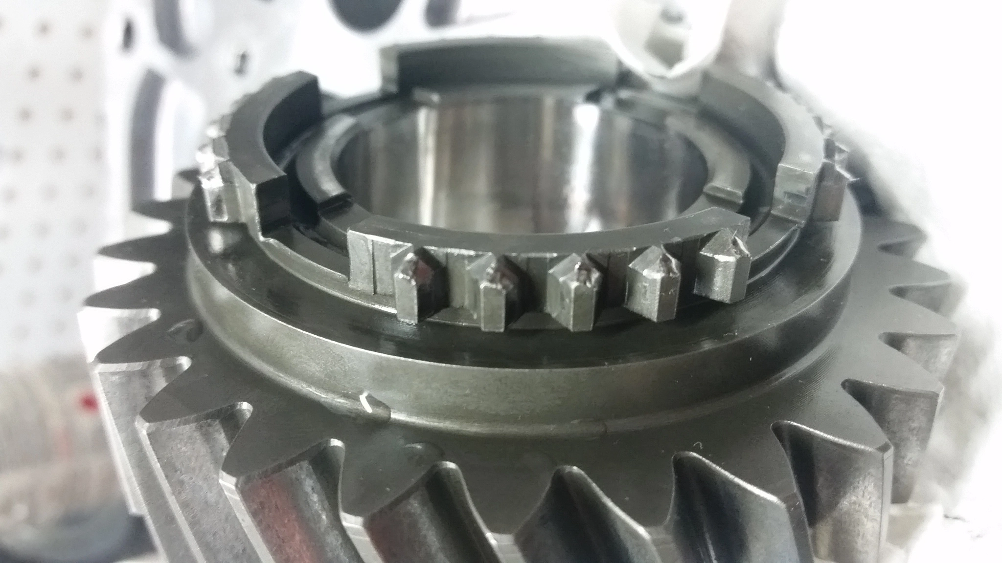

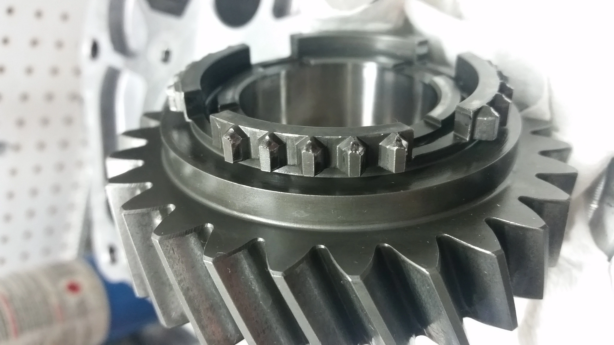

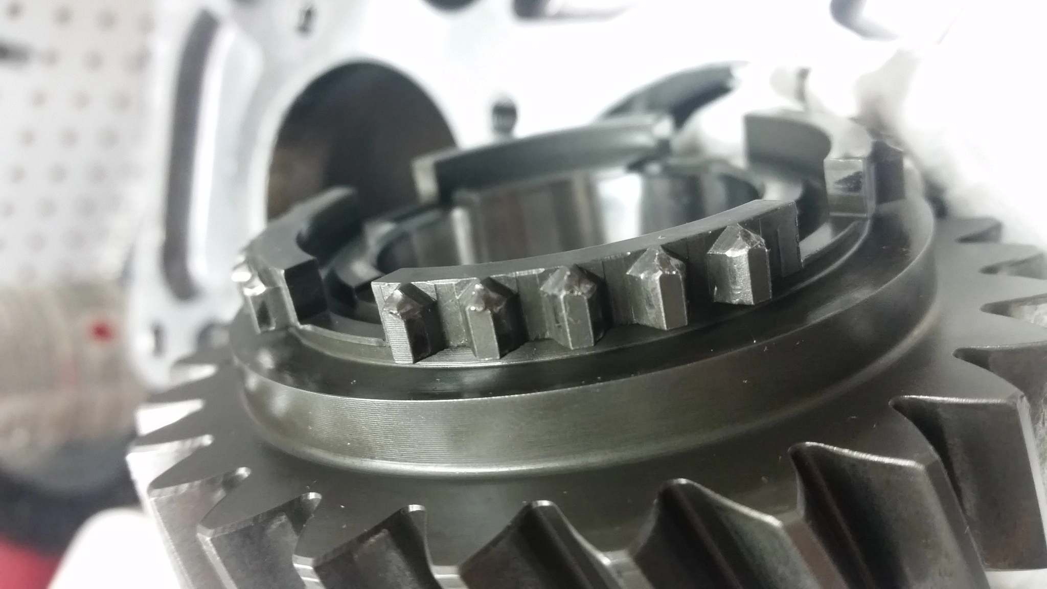

I tore my gforce t5 apart a few months ago for a rebuild. So far I have bought a master rebuild kit and both sliders. Originally I thought I was going to need a 2nd and 3rd gear because of the dog teeth being torn up. These cost a pretty penny from gforce, so I have been saving.
Tonight I went back over my old parts and for the life of me I can't figure out why I wanted to replace 3rd gear...it looks really good. 2nd, I am not so sure about. I took pictures of all the teeth. What do you guys think?

Those dog teeth are worn. They need an edge at the corners to let the slider engage better. I've filed the gear teeth before and it held up....for a while. Since you're in there already I'd advise going all the way and replace them.
With dog teeth like that you won't get shift as crisp as you'd probably want to. Nothing like having to hold a shifter in second....or bouncing off of second or third.
I have tried researching the dog teeth, but there is really little info on how badly worn they have to be before replacing. My first thought was the same as yours, but I ran across a T5 rebuild on a camaros sight.
The consensus was that as long as there were no spurs and the sides of the teeth were straight, it would work. Guy claimed that he reused them with new sliders and it shifted fine.
I will probably replace, but at $235 each, I wanted a second opinion.
Joe
I would also replace that gear due to the mashed dog teeth. Just not worth the time/energy to pull trans again and replace if you take a chance.
But a new blocker ring should grab the gear and slow it down enough to not grind. The problem will be when the blocker wears over time.
How did the gear get damaged? Were you grinding? What does the mating edge in the slider look like

The sliders look a little worse. I have already bought new sliders. The damage is from years of hard abuse and passes at the track. Some missed gears, some powershifts, and I think the break down of the blocking rings over time.
Yes, the trans was starting to get a little crunchy at high rpms, and I was getting blocked out of shifts. Normal driving wasn't too bad.
Looks like I will replace that gear and I am going to do the billet key upgrade too. Supposedly it helps high rpm shifts.
