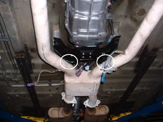

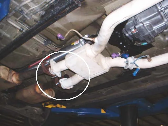

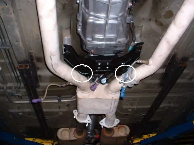

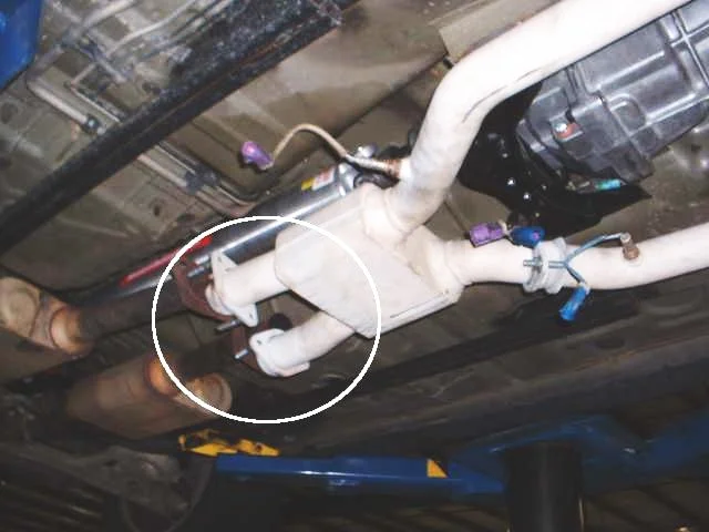

Midpipe:
The crossmember included with the D & D kit is much thicker than the stock crossmember and sits further back, so my MAC prochamber won't line up with my catback anymore.
I bought a new MAC catted H to replace it. It fits, but it's WAY too low to the ground. I can't drive over the slightest speed bump without scraping. It will take a bit of work at a muffler shop to put it back where it's supposed to go.
The catted H doesn't have the unique sound of a prochamber, but I'm quite impressed nonetheless. It screams American muscle through my flowmasters. I'll be in for a dyno tune in a couple of weeks, and I'll see if it makes as much power as the prochamber.
