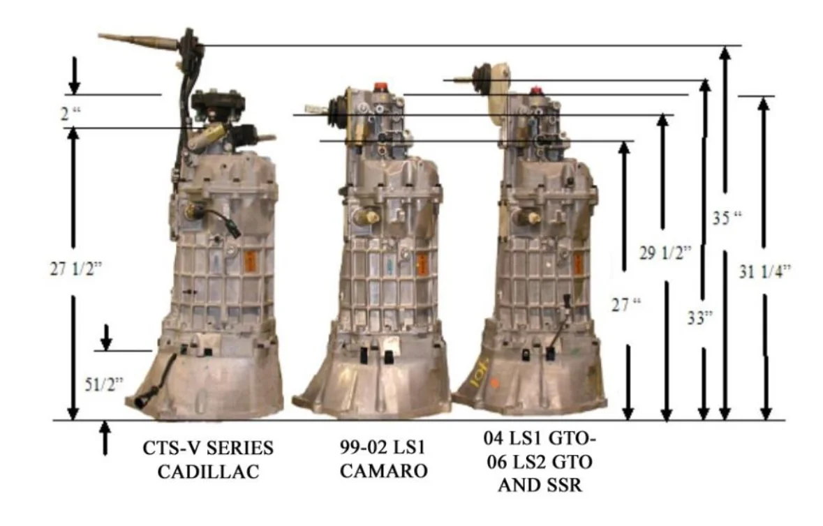

The cases are physically the same length. The QuickTime bellhousing appears to be shorter in length than a standard T5 bellhousing so I am wondering if that is where its it made up i.e. moving the transmission forward.
Tremec T5 Fox Body - total length A + B = 26.7"
Tremec GM T56 99-02 LS1 Camaro - total length = 31.25"
Difference of 4.55"
The Lakewood bellhousing (LK9100K) is supposed to be 6.33" from face to face. I believe the stock GM bellhousing is 5.5" but I am still researching that. Also found this info over on First Generation Camaros.net:
The rear most shifter position for the LS T56 is about 29" back from where the bell meets the block. The further forward shifter location on the LS T56 is approximately 19.5" back from the engine block.
So still digging around. I have a couple weeks to make up my mind on buying the trans from my buddy.

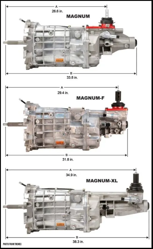

If you take the 7 inches from line-B of the T5 diagram from the 26.6 inches of A in Trogdor's post, you get 19.4 inches. O_o
That's preeeeeeeeeeeeeeeeetty close to line A of the T5 diagram up top. 1 inch! Super simple to makeup with a MGW shifter.
Would have to see what that Magnum tail housing and output shaft cost and if anything else is affected. Might be expensive enough to kill this being a cheap way to move to a six speed.
