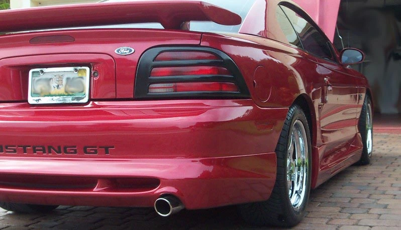

For some reason i only like the 94-95 lights with the Saleen Tail light covers. I have them luckily but Saleen no longer makes tham. That said if for some reason my tail lights and saleen covers were broken, then i would probably go with some 96-98 lights with the bezels painted black.
xkuntrycowboyx said:
SOMEONE post a pic of the saleen taillight covers! plz! i don't even know what they look like
