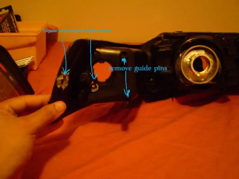

ok, Preheat oven to 250-270 Deg F. :shock:
Remove bulbs, rubber hoses, 2 hidden screws, and the guide pins.
Turn off oven and put headlight in for 5-7 mins. This loosens the glue.
CAUTION!! HOTT!!:rolleyes:

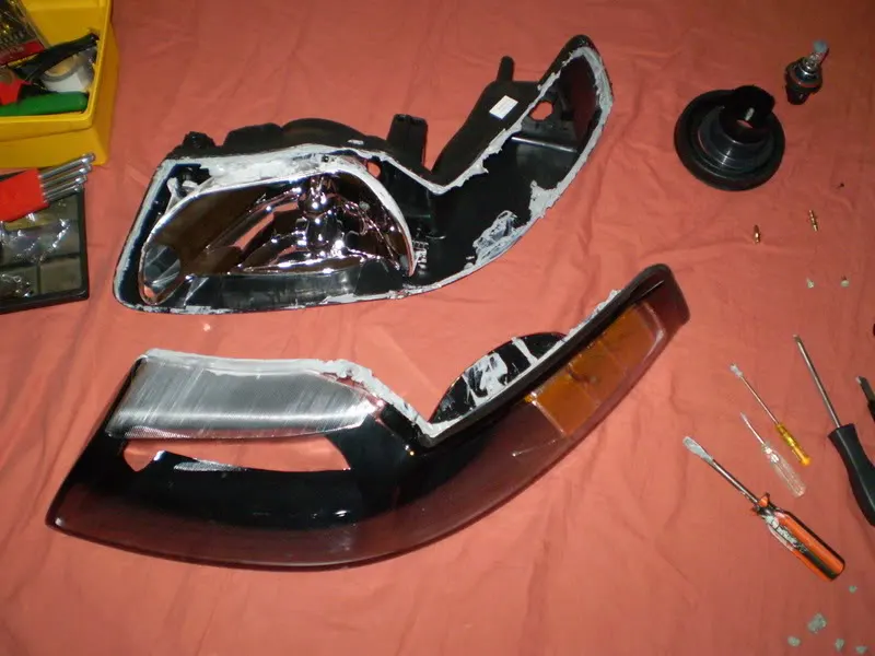

remove from oven and start working the lense apart. This is a bit tricky to get started, try at the turn signal first and work your way around. You may have to reheat the oven and place the headlight back in for a bit.
Use various flat heads to keep the area you seperated apart while you spilt futher.
eww messy
