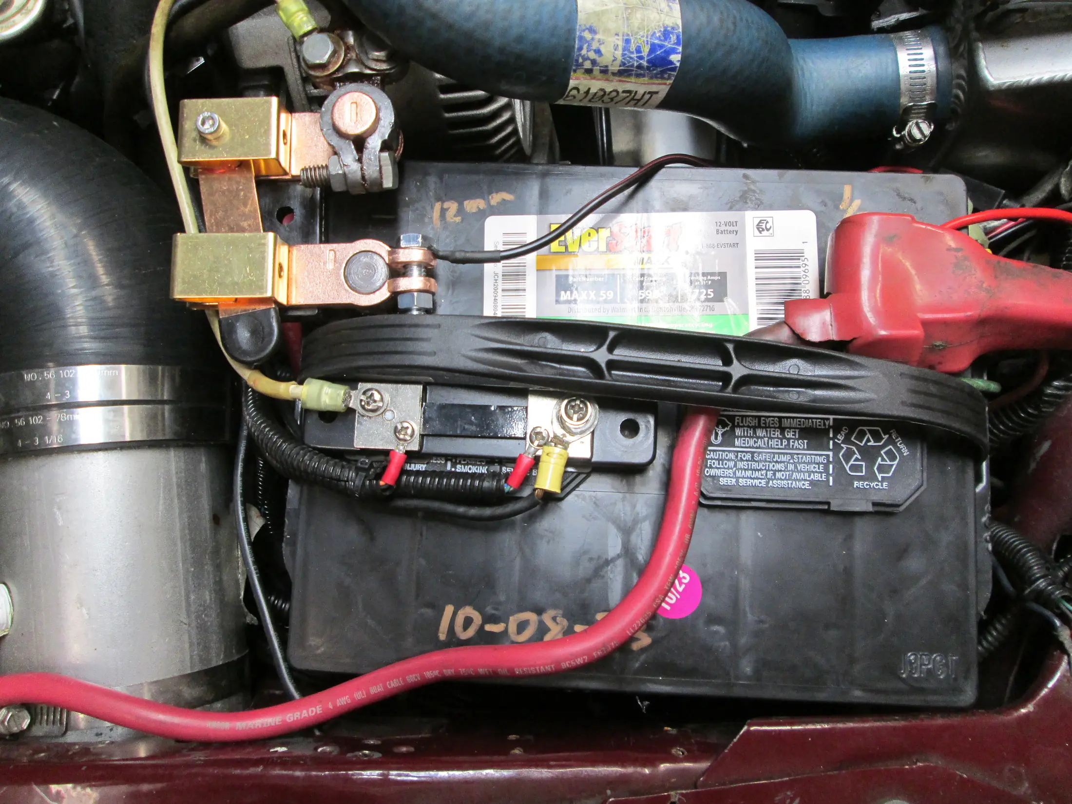

I just got a new one from AAA. They no longer spec the Group 58; it's now the Group 59.
Wasn't sure it would fit, since it's a little bit bigger. But it does fit & has a little more capacity for only a few dollars more.
I did have to change the location of the alternator fuse & the positive cable now goes across the top of the battery.
Might get a longer cable, but my current ones are marine grade.

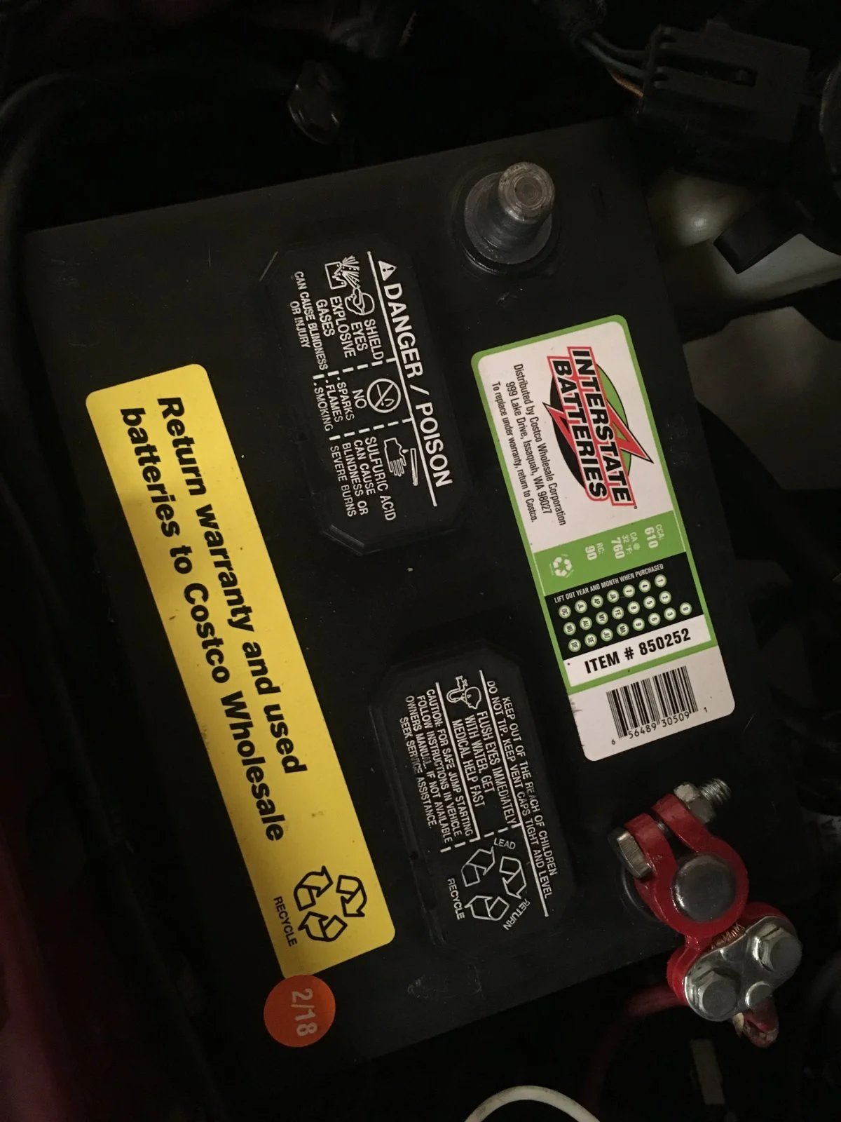

The most recent battery I bought was from Costco for my 93 convertible. It is an Interstate brand.
I just put a group 65 AGM from Advance Auto in mine. Fits like a glove and has authority when I start the engine unlike the small group 58 it replaced.
Interstate group number is on the front, not the top.
That doesn't appear to be a 58 or 59.

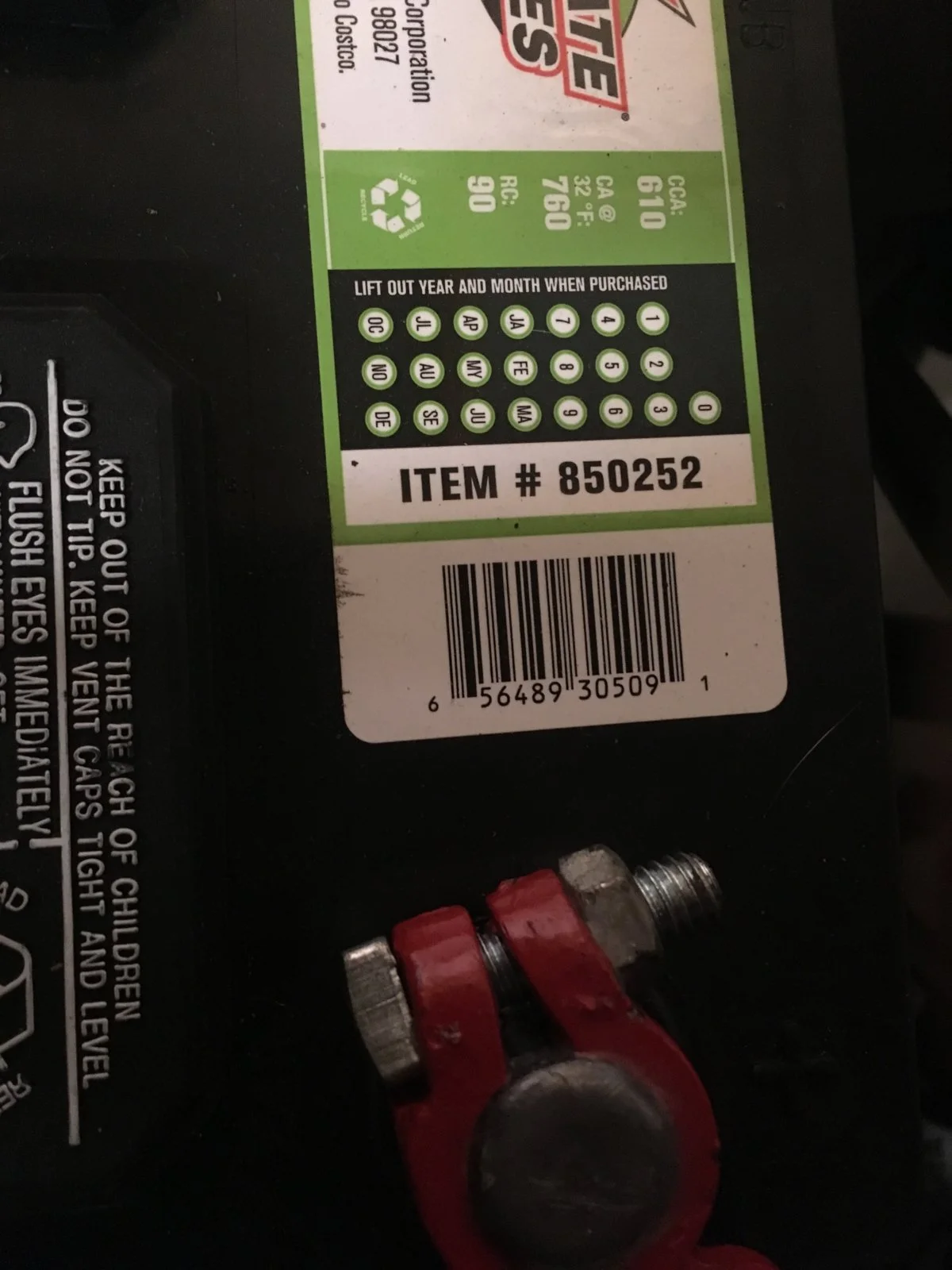

I just checked the front of said battery and it says group 58. The same one I posted a pic of the top label showing 610 cca

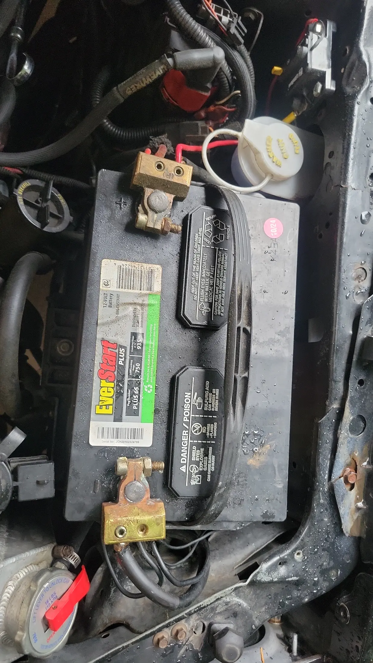

Do Type 65 batteries fit in the stock battery tray without modifications? Getting ready to replace my Type 58.
Specs say it's 2 in. wider. How is that going to fit the stock battery tray? A Group 59 is slightly larger than the Group 58.
Because of the ProCharger supercharger, the stock battery tray is moved from the driver's side to the passenger side, where it's located on the 4 cyl. The mounting holes are already there.
