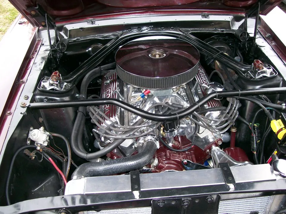

These clear, not sure what your looking for, but they have a nice clean look without the stickers. LOL
They clear my stud girdles with no problem. Tight fit coming off with the braces but they still do, just a little work.
Clears this no prob.
Dunno if that helps any.
