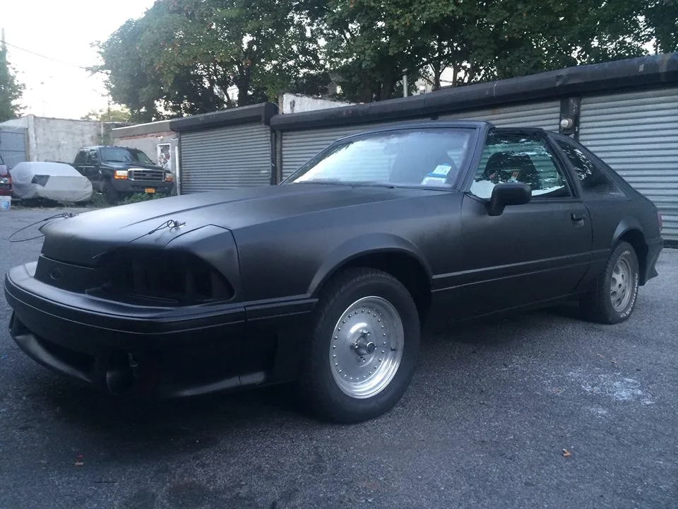

Hey guys I have a 347 Stroker motor I hand built. I have probe racing internals. It has a holley 750 Carburetor. 7qt Moroso Oil pan. Cast Iron GT heads ported and milled. approx 11.0 Compression.
The engine fired up and ran from day 1. My only dilemma is valve-train noise or what seems to be valve train noise. I have only started and driven the car around the block for testing.
After a few starts and testing the motor, it started making this tapping//knocking/tractor sound from around the heads/valve-train.
background on the valve train. Comp Cams Xtreme energy cam with .575 lift on exhaust .565 on intake. i have comp cams hydraulic lifters, measured push rods going into 1.6 full roller aluminum rockers double spring comp cams and i forgot what valves. What I do not remember doing was tightening the rockers down in any specific order however I was told that didn't matter since they are pedestal mount rockers(not sure if I believe that i don't have to do them in the turn the motor over by hand check style and tighten flow).
Last night i took off the valve cover everything seems to still be as snug as I remember. push rods have no play are solid on the compression phase and slights spinnable during the uncompressed phases of the valve (possible valve float issue?)
Now the sounds always seems to be traveling.
I thought maybe it was lubrication issues but there is the Melling HV oil pump and the 7 quarts double sump keeps oil in every place it needs to be.
could this just be a pinging issue for timing? or is it mechanical in the valve train?
to make it clearer in what it sounds like, picture an old Volvo diesel truck =P
Thanks in advance!

yum charcoal grey! I love dark colors. I painted mine with the Rustoleum Flat Paint and I AM IN LOVE!!!

Hey so I have an update.
Aside from the heads I finally put on my Rear centerline wheels with NITTO Extreme Drag tires today.
i DIDNT change the pushrods yet BUT i did a complete/semicomnplete tuneup. Spark plugs Oil and Oil filter. It seems that maybe the engine oil was all broken down and/or didnt have enough oil that was causing the tapping.
The tapping is pretty much GONE. I still get some tapping(which is more than likely from what I have been reading can primarily the XE Comp Cams Roller cams' aggressive open and closing ramps) but NOTHING at all like before. It sounds more cushioned and flowing and less clackitty-clackitty-clack. the engine is much more responsive and feels tougher. One weekend soon i WILL change the pushrods to the shorter 6.248 for testing, but for now I will leave the 6.350.
I forgot to Mention I have a 7 quart double sump MOROSO oil pan. I put 7 quarts plus one to make up for whatever gets lost in the oil galleys and oil filter. she feels stronger than ever.
could just be as simple as broken down Oil and not enough of it.
