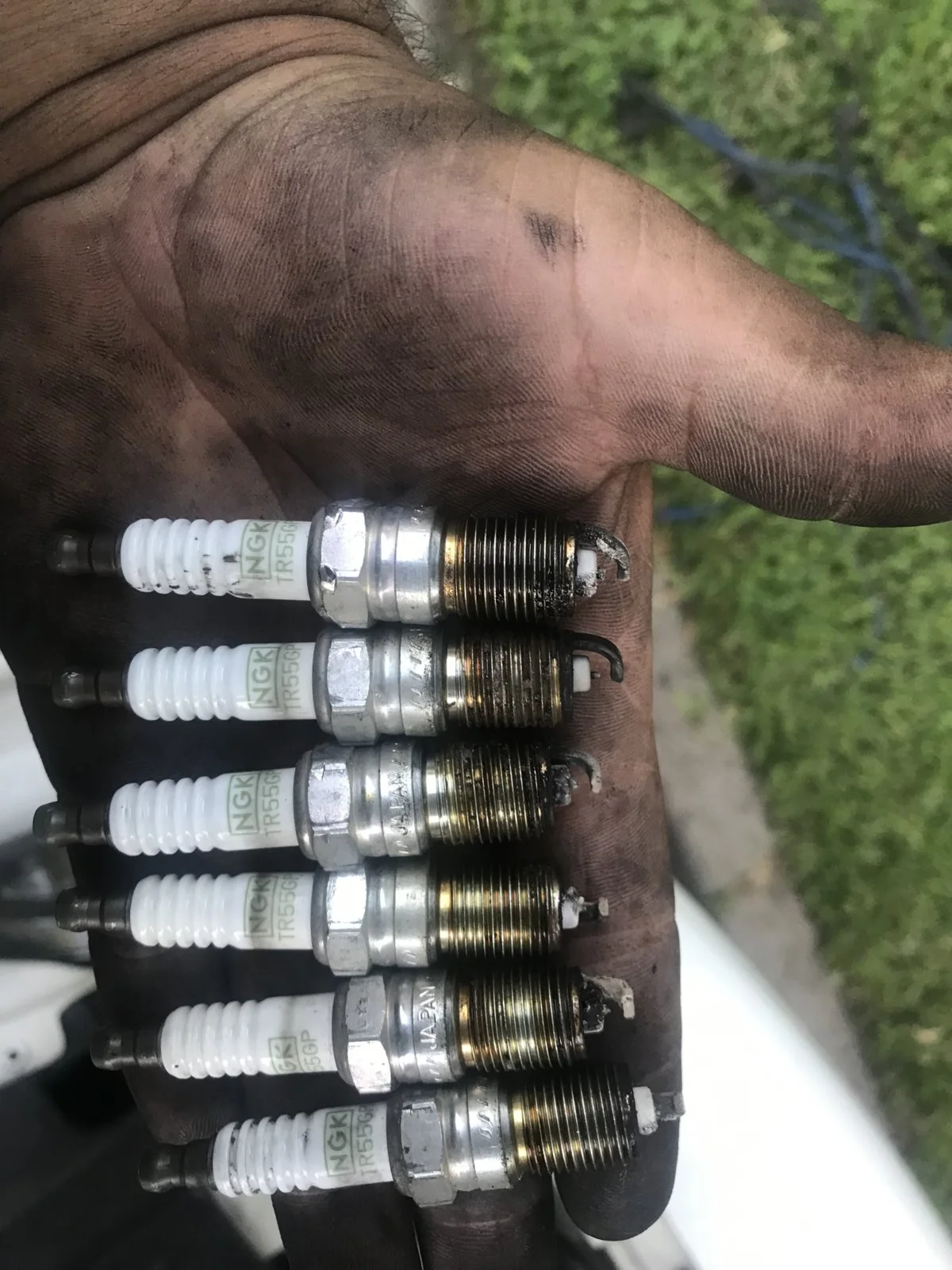

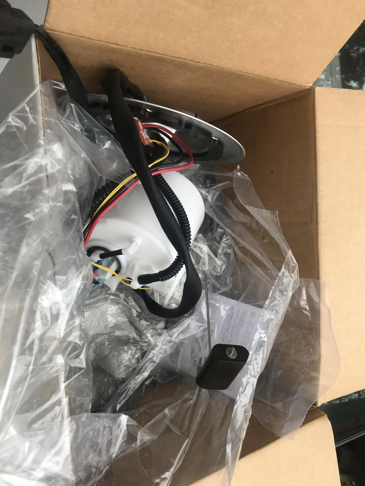

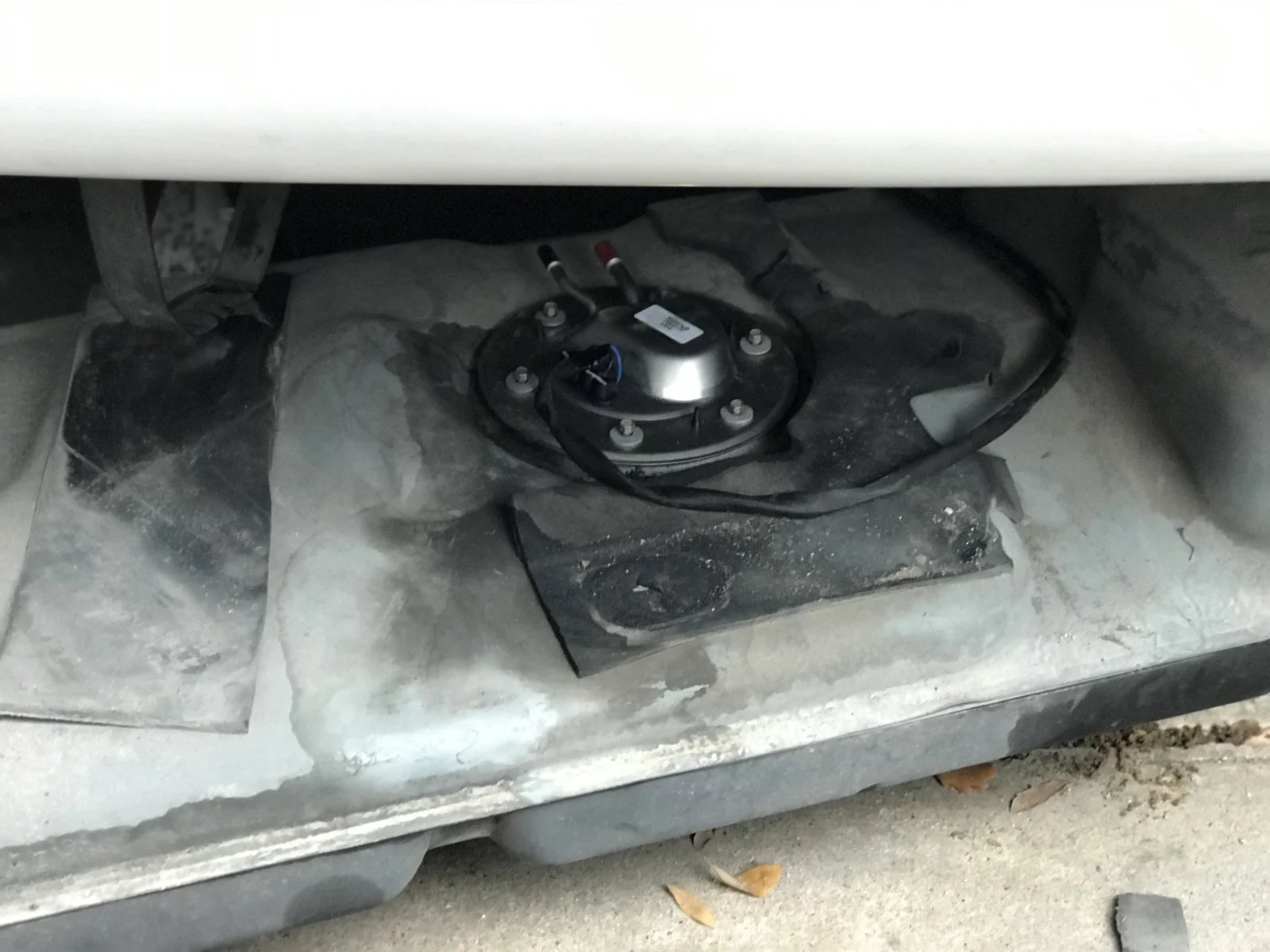

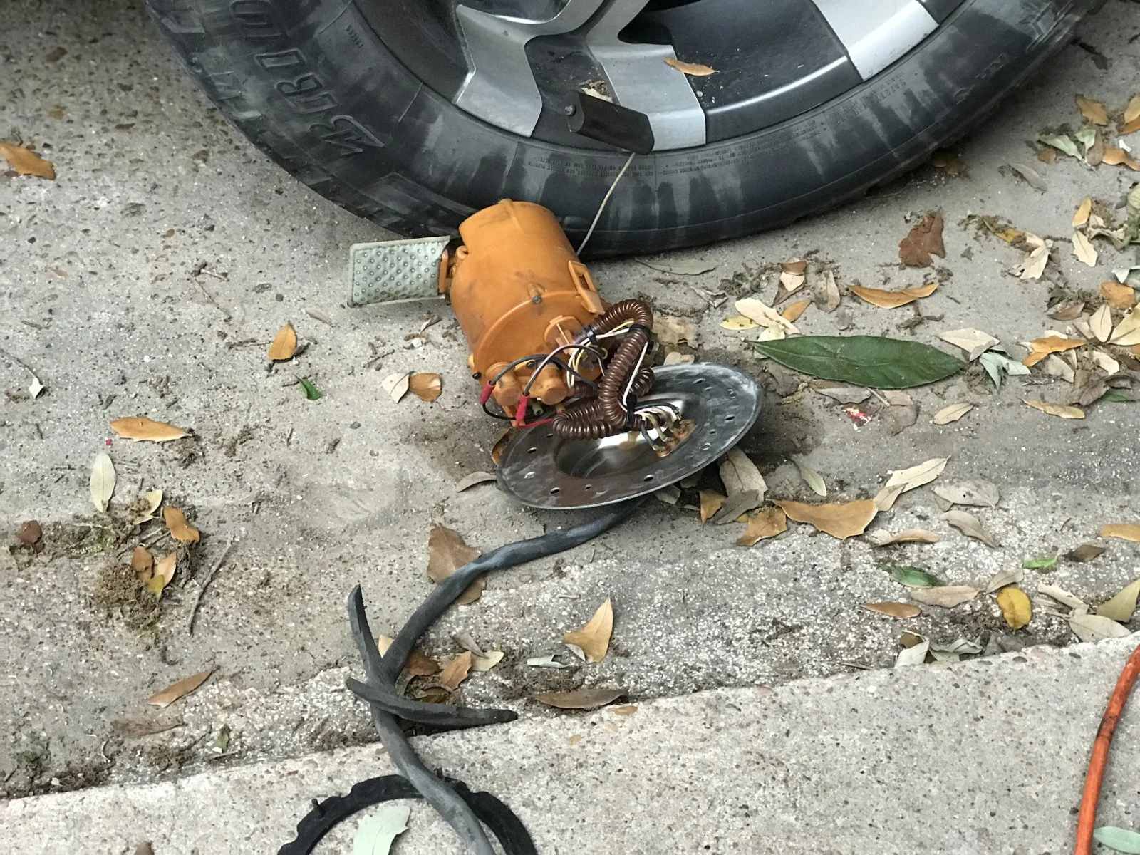

Its been a while and long since replaced fuel pump. It gave out on me one day thankfully not too far from home, had my dad tow me home lol. Upon replacement i did a full tune up and replaced other components. The tapping did in fact originate from the fuel pump no clue why but my guess was not enough fuel coming from the pump causing it to suck more than there was similar to emptying a capri sun. The pump was a junkyard pump put in by previous owners of the car. I put a walbro 255 and replaced fuel filter. Plugs, wires and distributor block. Running lean for too long pre maturely killed all of my spark plugs. Causing it to misfire when pump was replaced. I also replaced fuel pressure regulator and throttle position indicator thinking that was causing problems but hey those were cheap and it wouldnt hurt getting new parts lol
