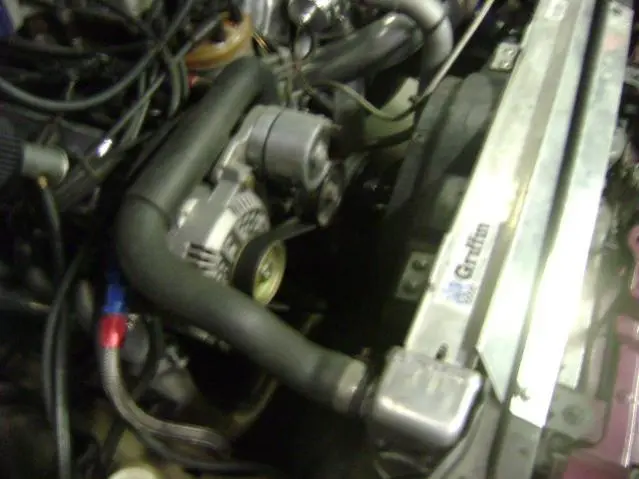

here's one of the top I will get the lower tomorrow its to cold to climb under that thing tonight. Some one asked how we/I wired them up I run mine on a 40amp circuit breaker and a 40 amp relay.. I also made plates that go under the shroud also so the rivets don't pull through
I like that...I've seen some aluminum like that lyin' round somewhere
