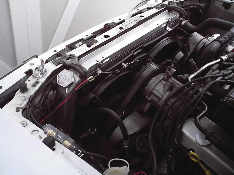

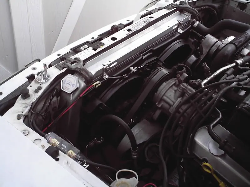

FWIW i run a "ramcharger" fan, its actually an intrepid fan.
i got on ebay and search up dodge intrepid electric fans, IIRC the years 98-04 are the years to get. i got a brand new aftermarket fan for 100 bucks, its a dual fan, and with a little trimming it it fits over the radiator nicely.
it cools nicely, doesnt even have to use the fan at 100% to cool the car. i use a DCC fan controller and the fan doesnt even have to work very hard to cool the car.
so far the fan has worked great.
heres a pic
