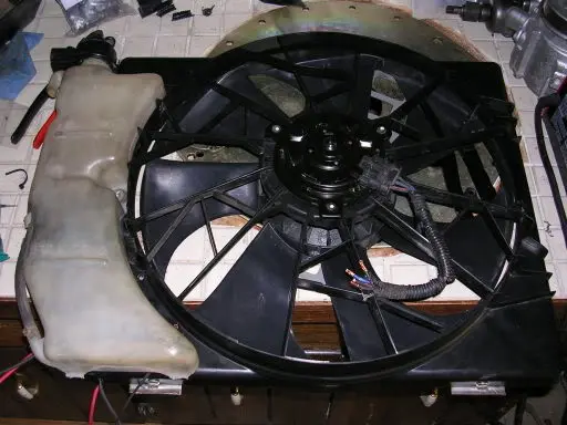

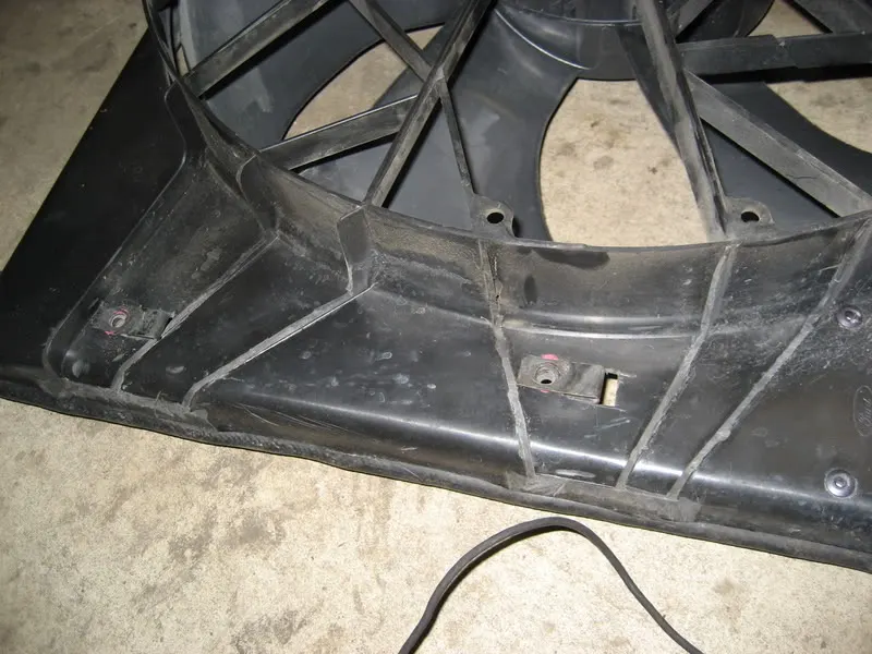

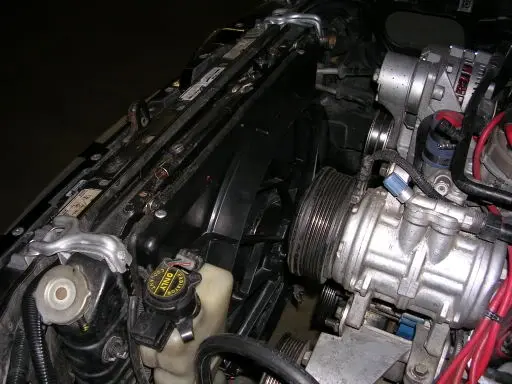

i remember seeing pics of someone who mounted their fan upside down and reused the factory overflow bottle....does anyone know who that was or where i may find the pics? i was unsuccessful with the search...thanks
jim
I know what you're talking about, they mounted the fan inside the stock fan shroud to keep the overflow....Assuming he trimmed the outside of the fan to make it fit in there but maybe not.
jim
Yeah, I did that, but I don't think you could flip the fan upside down cause there is only room on the one side, of course it really doesn't matter which side is up and which is down.
Wasn't too hard to do, just ground down those fin things and use the factory j-nuts and bolts and some washers.
