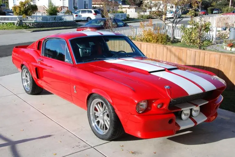

I am using the Tcp complete front suspensions with 450 lb springs and the fully adjustable shocks and a 1" sway bar. In the rear I am running the Maier racing 165 lb race springs and their adjustable panhard bar. The car is great at high speed sweepers, I have even had a friend who tracks an M3 say it sticks very well. The car does push in the low speed corners and I am hoping with some more negative camber I can get rid of that. But, I also run 275 tires in the rear with 245's up front so I am sure that does not help the push at all. Here is some more video at Thunderhill raceway and the first time the car was on the track.
YouTube - Mustang Fastback at Thunderhill Raceway
The car is now painted by the way.
But I cannot get a picture to work.
