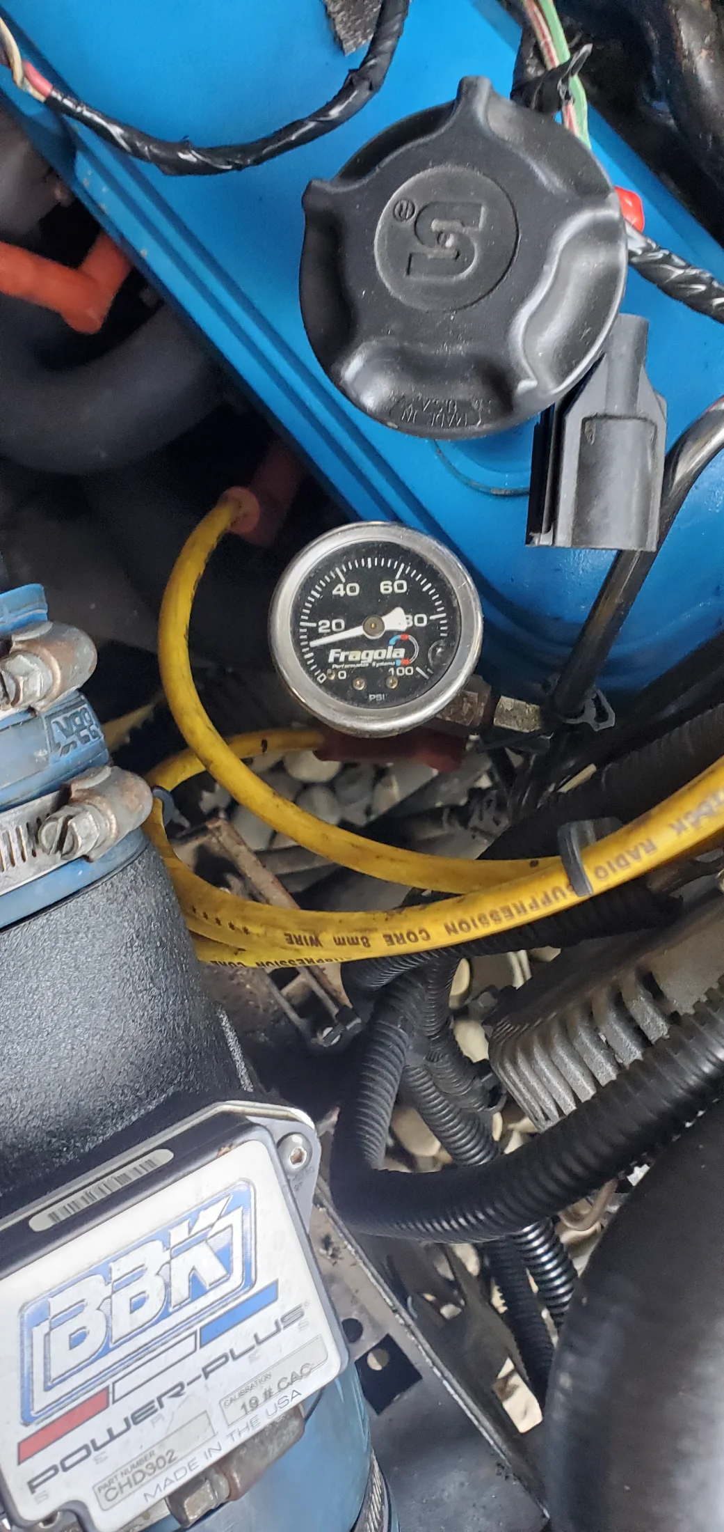

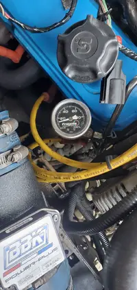

Regulator is good. Replaced recently when I smelled strong gas in the vacuum line. O2 sensors will be added when I drop exhaust. Fuel pressure is another story. Pic is car running and warm, seems low to me, yet still overfueling like no tomorrow. I am going to replace timing components so I'm not gonna worry about tryin to get pics of balancer.

So it is trying to read the O2's when it hits temperature and since they are out in the open and reading high on O2 it the ECU is probably trying to pour the fuel to it to correct that. Once you bet the bungs welded on and them installed that will help this whole mess.
The fuel pressure is way low. Should be 39 psig with the vacuum line disconnected from the FPR (plug the vacuum line) and the engine at idle.

As for fuel pressure, car runs like a frickin champ. Lots of power. What in the hell would cause pressure to drop so low? Faulty gauge? Just doesn't make sense to me that fuel pressure is hella low yet I'm running super fat. What am I missing!?!?
