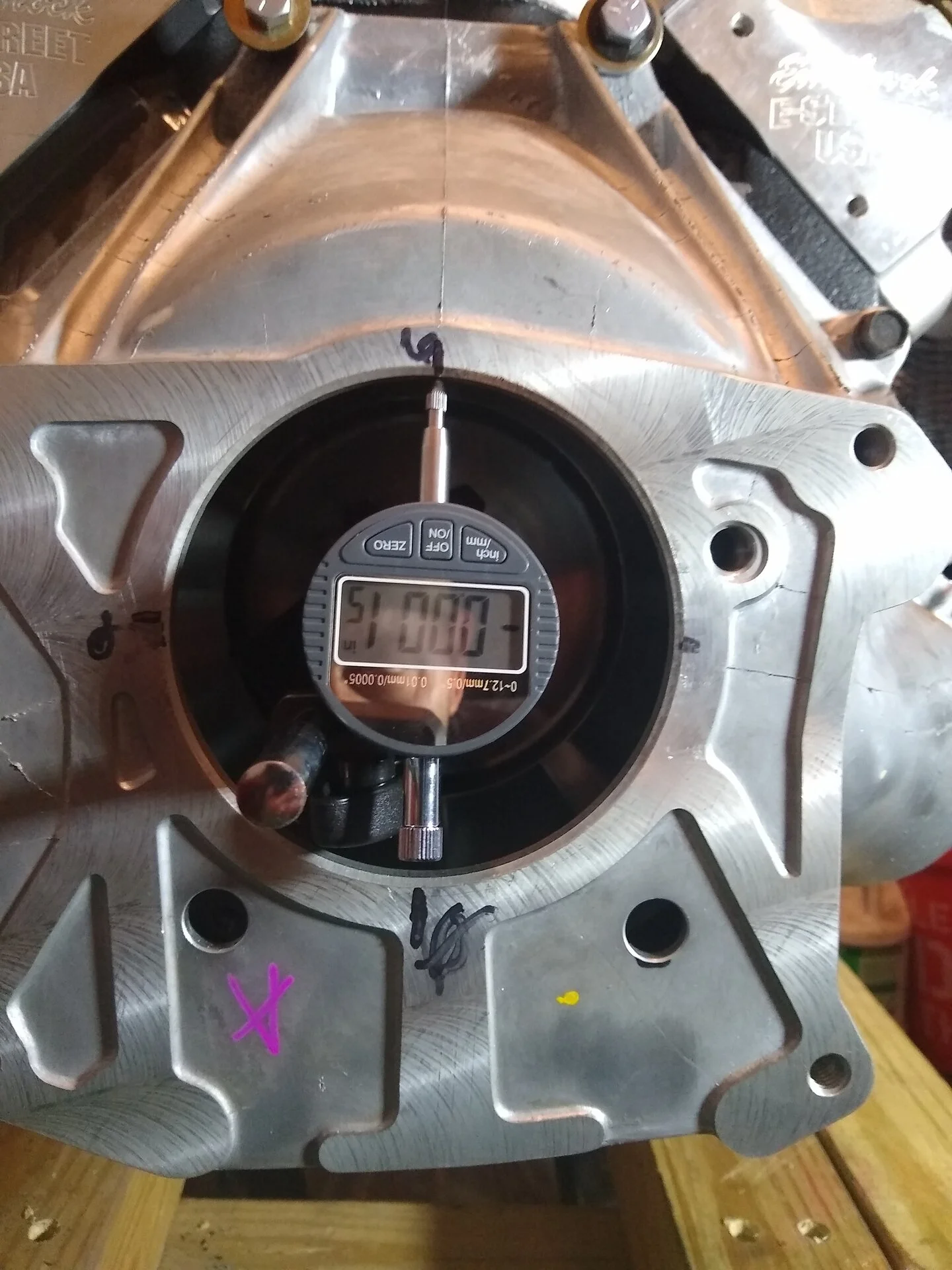

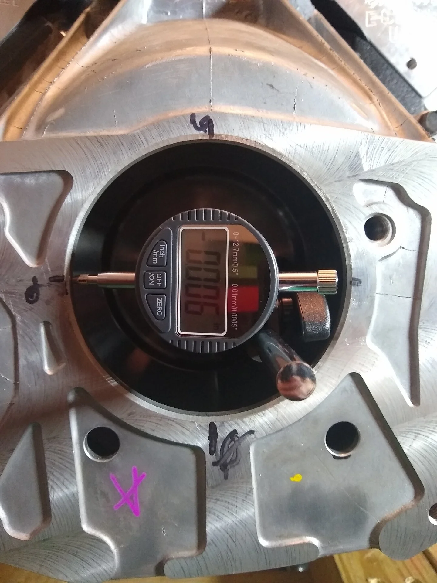

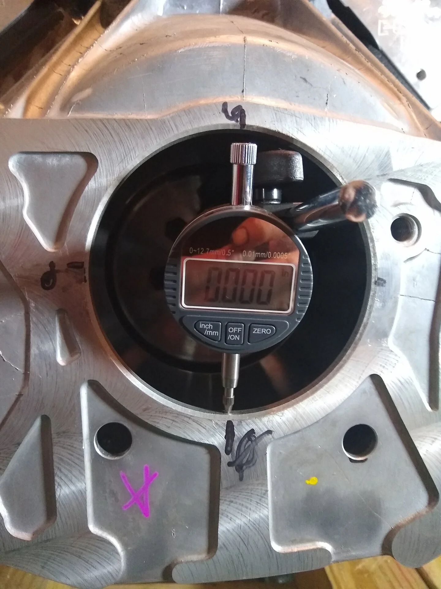

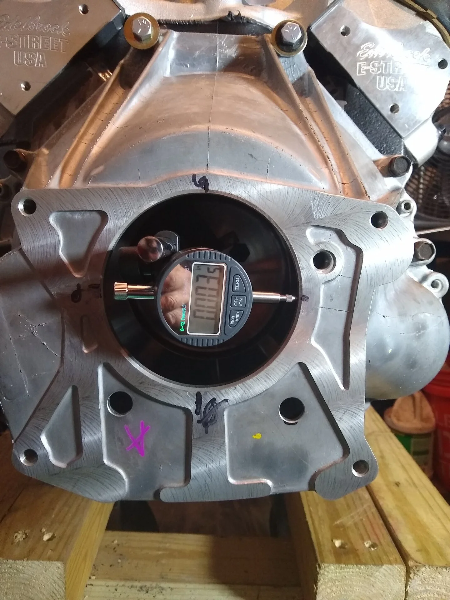

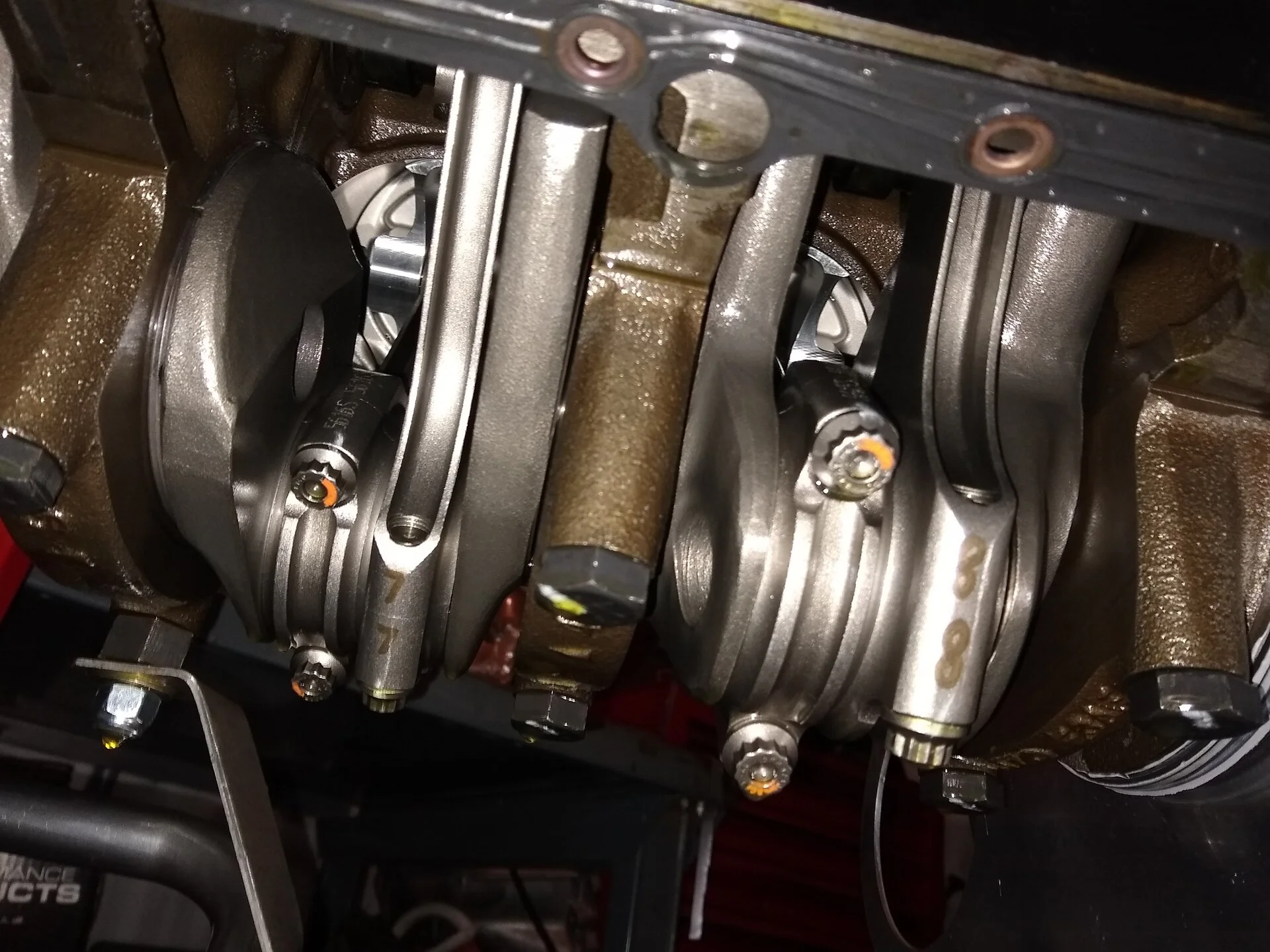

Whoever did the machine work did they use a torque plate and did they align bore the main caps for the stroker crank?
Are you sure all the chamfer sides on the rods are facing the crank fillets?
The other thing I saw others suggest is it being possibly the bellhousing alignment.....It is very important but if it does it in Neutral and driving its not likely.....
I got mine down to almost dead nuts perfect but anything more than .010" out is too much and must be adjusted using offset dowel pins......
