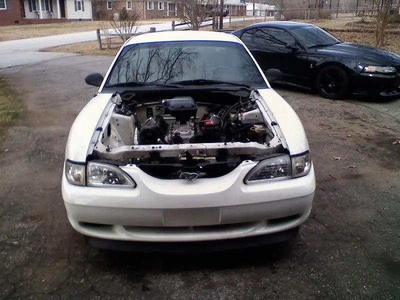

Dog gone it!
I forgot all about the CPS.
That would make the swap nearly impossible using the stock ECM.
Stopsign:
What the heck kind of upper is that???
