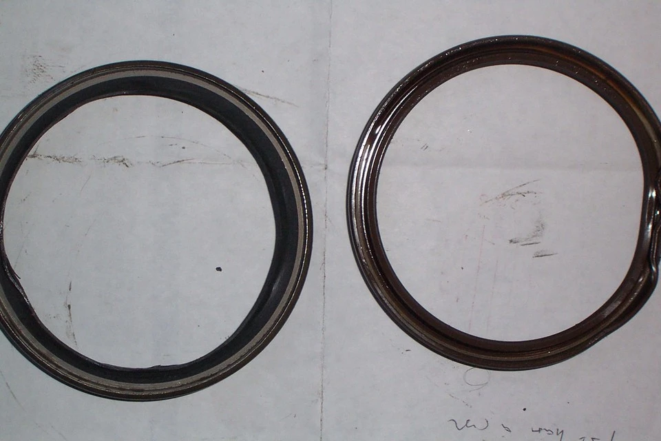

While my transmission is down I decided to replace my leaky rubber rear main seal. I bought a teflon one after reading some posts but I managed to damage it before I got it installed. The one on the left is the teflon one and the one on the right is the rubber one that I removed. The inner diameter of the teflon one is smaller and won't slide over the crank. Do I have the right part or is there some way to install this correctly? I've read that the teflon ones are hard to install.
I'll be picking up a new teflon one from Advance tomorrow and comparing it to a rubber one and the one that I got from Napa.
Thanks for any input on this. Barney.
No, I didn't put oil on the teflon side. It seemed like it was'nt even close to clearing the crank. It also seemed that the teflon was tapered in the wrong direction and it folded when I applied pressure. I'll be curious to see what the part from Advanced looks like.

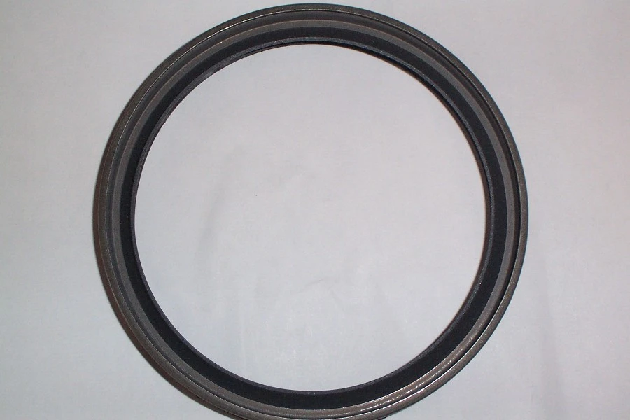

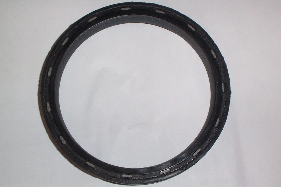

Now for the really stupid question. When I install the sleeve, which end should be facing into the engine and which end should be facing me when I get done?
I think this side faces out.
and this side goes into the engine.
Have I got it right or not?:shrug:
Thanks for straightening me out.

Yep, I have replaced the seals before. The 'spring' side goes towards the engine and the 'flat' side faces towards the transmission. Good Luck! Be patient when installing it. Don't let the inside lip get 'twisted'....
