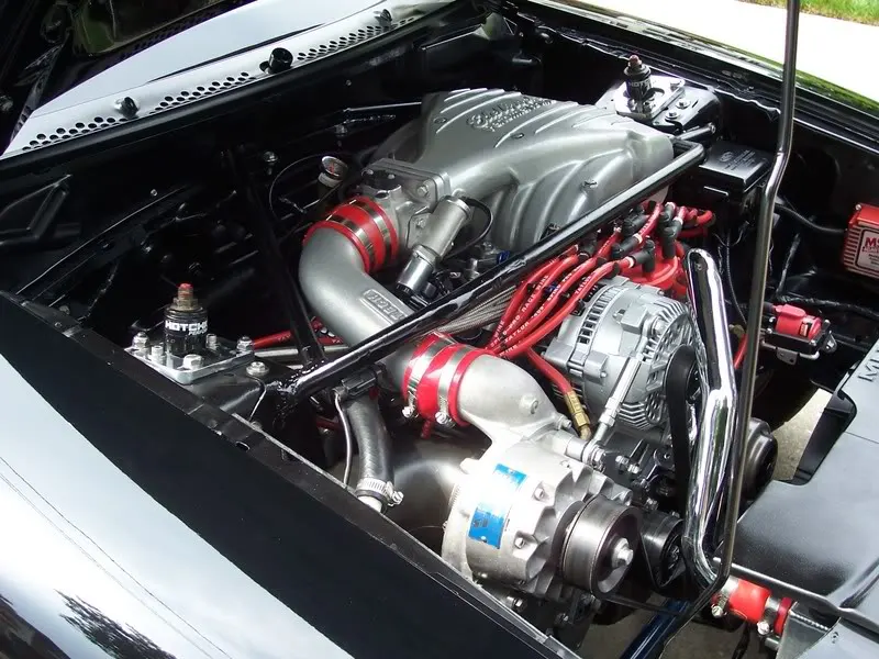

i used to have it down in the fenderwell, right after the maf sensor. after doing a bunch of research i decided to move it to the discharge tube coming off the blower. i drilled a hole, used a 3/8 npt tap, and it screwed right in. i didn't even have to lengthen the wires. you can see in this pic where i put mine.

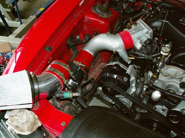

Mine is setup similar to what I have in the picture. You can see where the sensor hits the Strut Tower.
I now have a plastic 90* elbow in place of the 45* chrome elbow in the picture. I thought about moving it there, but that's in front of the M/A meter. :shrug: I really don't want to drill any more holes in the C&L pipe. I'm not really sure how much longer I'll be keeping it. :(
Moved the sensor to the elbow. Soldered on the new harness plug. The car now hot starts MUCH better. :nice: First 5 or so runs past 5,000 rpm it held just great. Then the next day. Same old BS... the tranny kicking out of third. :bang: I'm about to pull my grey hair out. AAARRRGGGGHHHH!!!!
