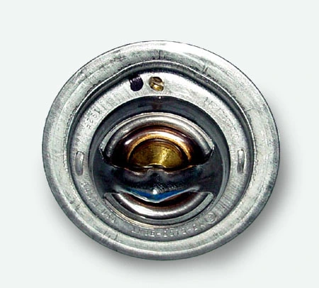

Could the problem also be that my 302 has a 180 thermostat in it? I thought that the older engines had like 160 or 165 stats. If so, what sending unit can I use that will read close to right?
