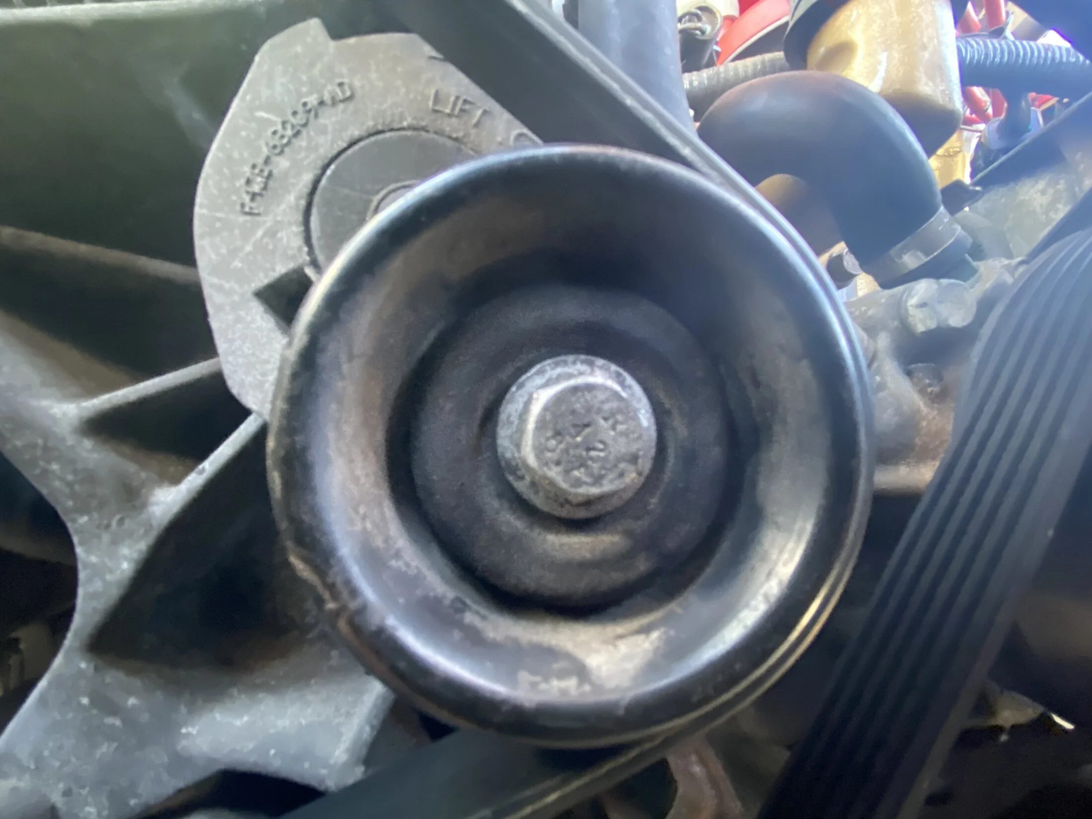

Hi all,
I’ve 95 GT, this is the second tensioner I’ve order from rockauto and doesn’t fit to my car .
Before I bought from rockauto(https://www.rockauto.com/en/catalog...+v8,1134188,belt+drive,tensioner+pulley,10346) double check with other websites to be sure that does really fit (https://www.stockwiseauto.com/gates...oner-pulley?Year=1995&Make=Ford&Model=Mustang). It should fit but it didn’t
Do you mind to help me choose right one - it cost a bit to shipping and taxes to Sweden. I hope third one will fit
The issue I’m facing now, the original pulley’s bolt and screw doesn’t fit to Gates 38006 :(.

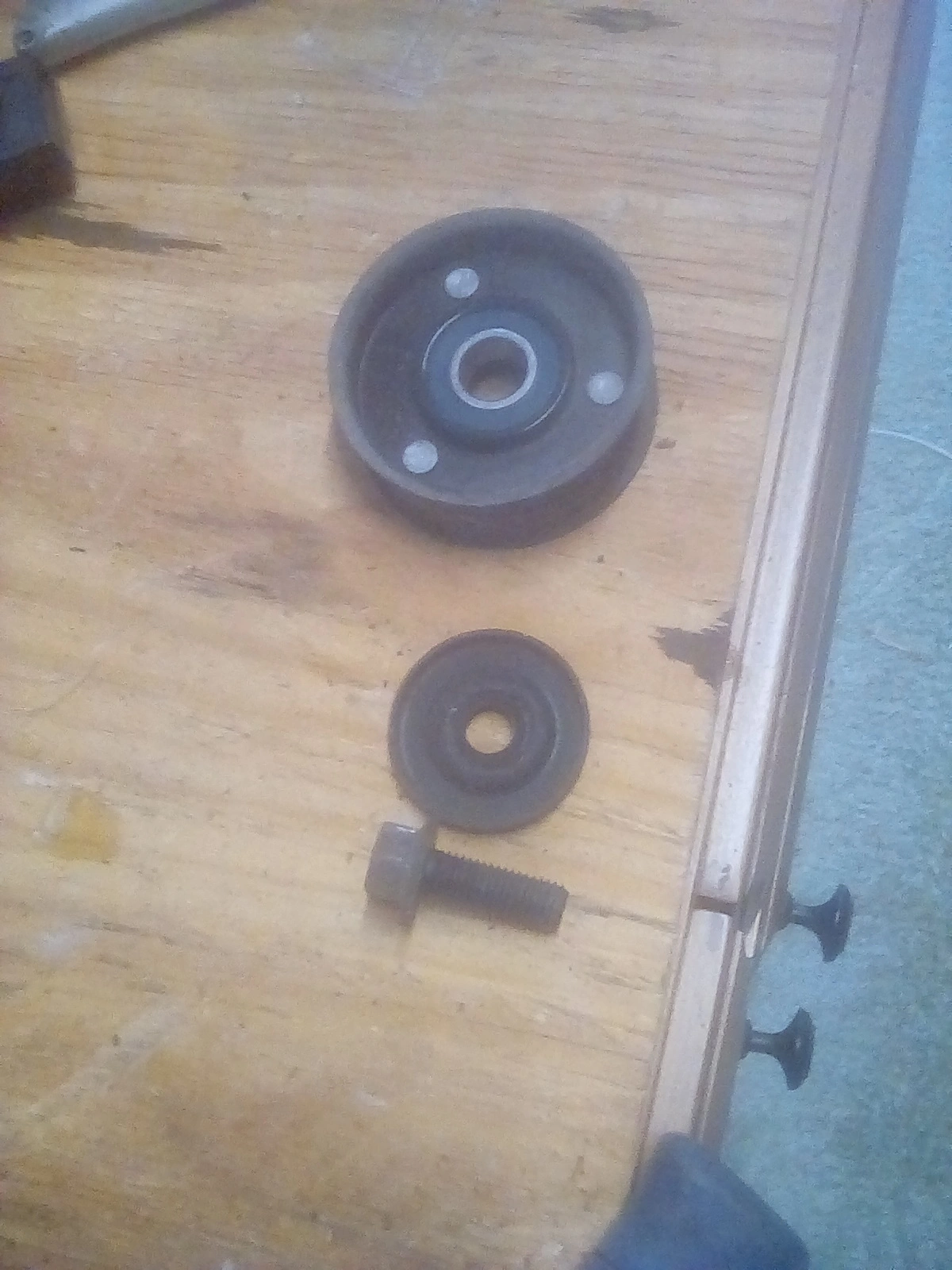

Pictures might help us help you.
  • Old pulley and screw together
  • Old pulley by itself
  • Screw by itself

It appears the pulley bearing is roached? The bearings (I believe there are two?)are pretty common and are easily popped out with a bench vice and replaced, Ford and others used the same pulleys and bearings on most all the serpentine belt setup.

Why not just replace the whole tensioner? If it’s old enough for the bearings to be shot, I’d say it’s time to just replace the whole assembly.

The request for pictures was to help understand what you are working with. The pulley itself should work. You may need a different size washer. Or, if the washer & bolt are not easily separated a new bolt & washer.
With the metal pulley is it easy to replace just the bearings and be right back in business. Cheaper also.
If your bearings are shot but the numbers unreadable it may help to push the bearings out and look at the other side. Those are very common bearings here in the US. Any industrial bearing supply business will have them on the shelf. Match up the inner / outer diameters and shielding. Press the new ones in and Done.

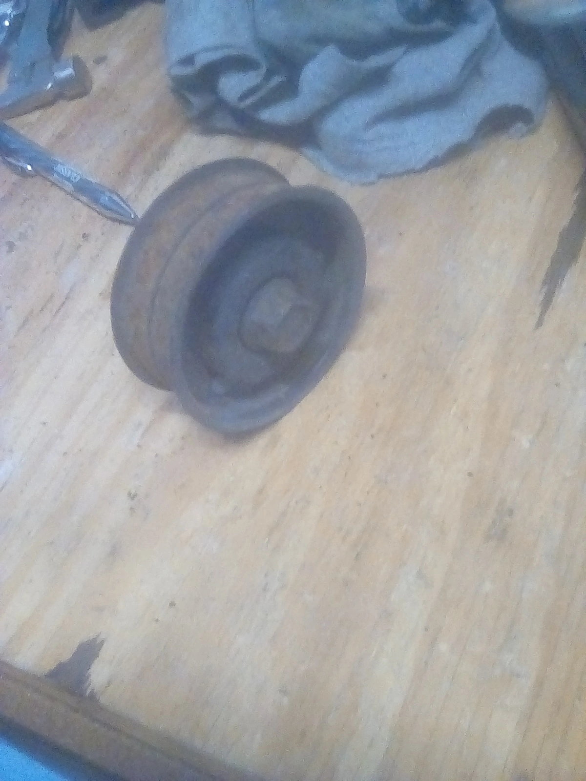

6203 LH National part #
You may be able to match that number to a part manufacturer on your side of the pond, my pjcs, however crappy they are, also show the pulley from the fox body model, your sn95 may have be different, I remember plastic pulleys but don't recall from what model. Also note this one has the shoulders like a guide, likely still uses the same bearing, I've changed them out with a big C clamp.
Ohh, and the thread on mine are backwards, lefty tighty, righty loosey.
