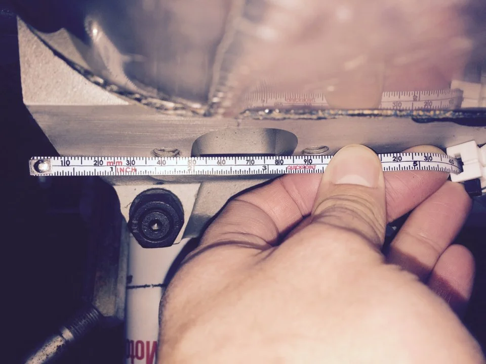

Hello,
I have a 90 LX 5.0. Long story short, the Trick Flow Aluminum heads were ported and flow a ton of air. Bad news is I took my exhaust gaskets up to them and they are too small now. There is not much room for trimming them wider. They fit the height but the width is now 5mm too large and the gasket is too small. Should I just put them on anyways or try to trim as much off as I can? I do NOT want any leaks though. i am kind of perplexed because the largest gasket I can find is only 1 1/4" wide. I need about an 1 1/2" or 35mm
Any suggestions?

If you can... Post up a couple snap shots of the gasket over the heads. Post one of the gasket over the header as well. Should help to make a little sense of what you have going on there.
Here is one pic.

It was easier to measure accurately with mm than inches. My gasket is too small but not much room for porting or trimming it. The headers are shorties from bbk.
If you are running shorty BBK headers, they header openings are going to be smaller than the exhaust ports anyways. You can probably open them up a little bit, but probably not enough to match that exhaust.
