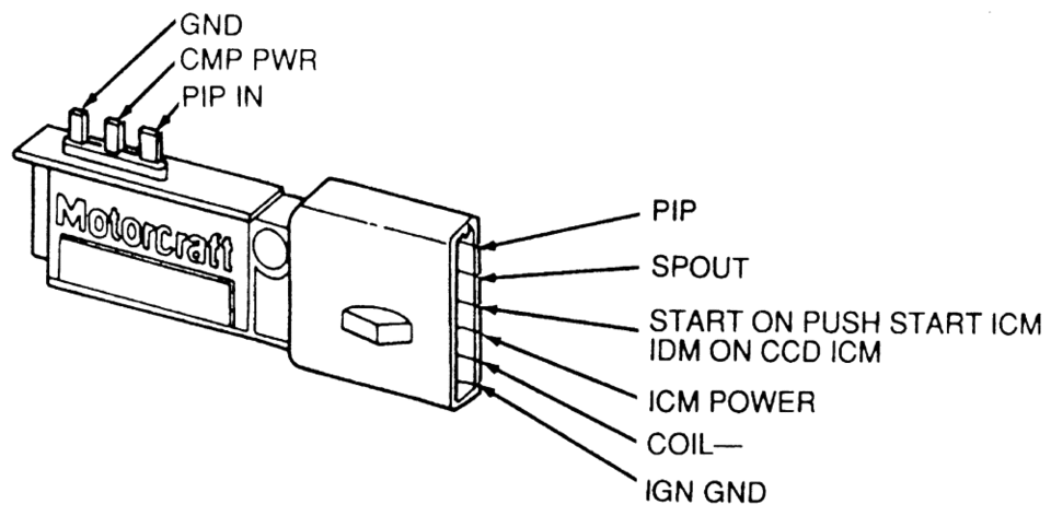

The autos and sticks had the same TFI. Early cars had grey push start TFI's and later EEC-IV cars had black CCD TFI's.

Even though there are different TFI part numbers for automatic and manual transmission setups starting with 1990 Mustangs (Motorcraft part #'s DY174 for M/T and DY1076 for A/T).....they continued to use the "push-start" wiring setup until 1993 for both transmission setups. SN95's were the first Mustangs that used a different wiring configuration depending on the type of transmission, and had different color TFI modules as Hissin50 mentioned above.
