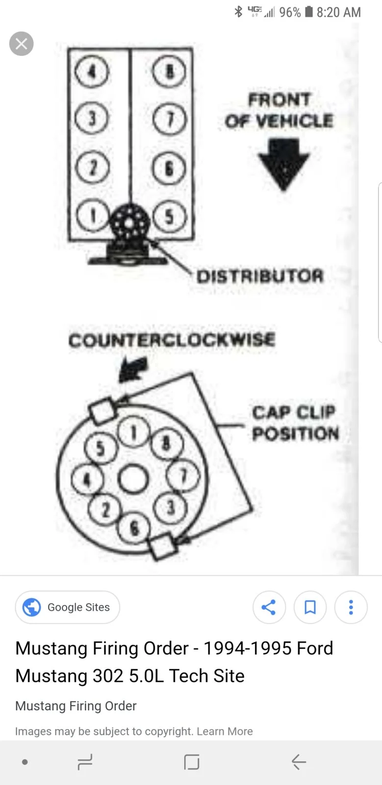

Pull the number 1 spark plug and verify TDC. ( sounds like you may have done that but always could double check ). Make sure the distributor isn't 180 degrees out.
Make sure number 1 is on cap in same orientation as pic
Reactions: Mustang5L5
going to make sure my diarributor is right i was thinking i was supposed to use it with how the firing order was on my 89 and distributor rotated in the position it was not how it should be in the 94 i hope this will work ! this is whar ill try first
