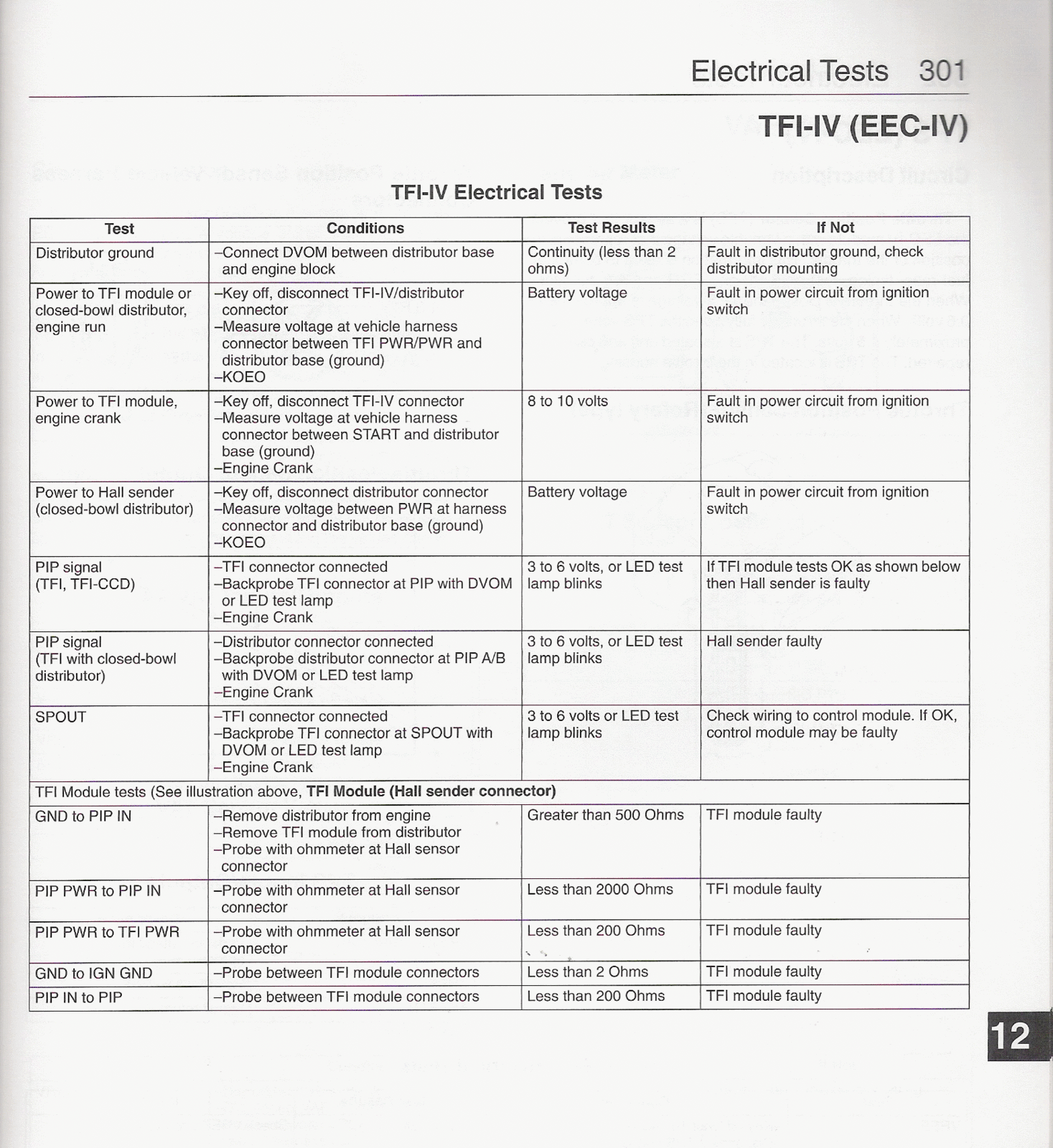

MIght want to look this over maybe it'll help.. It's from
