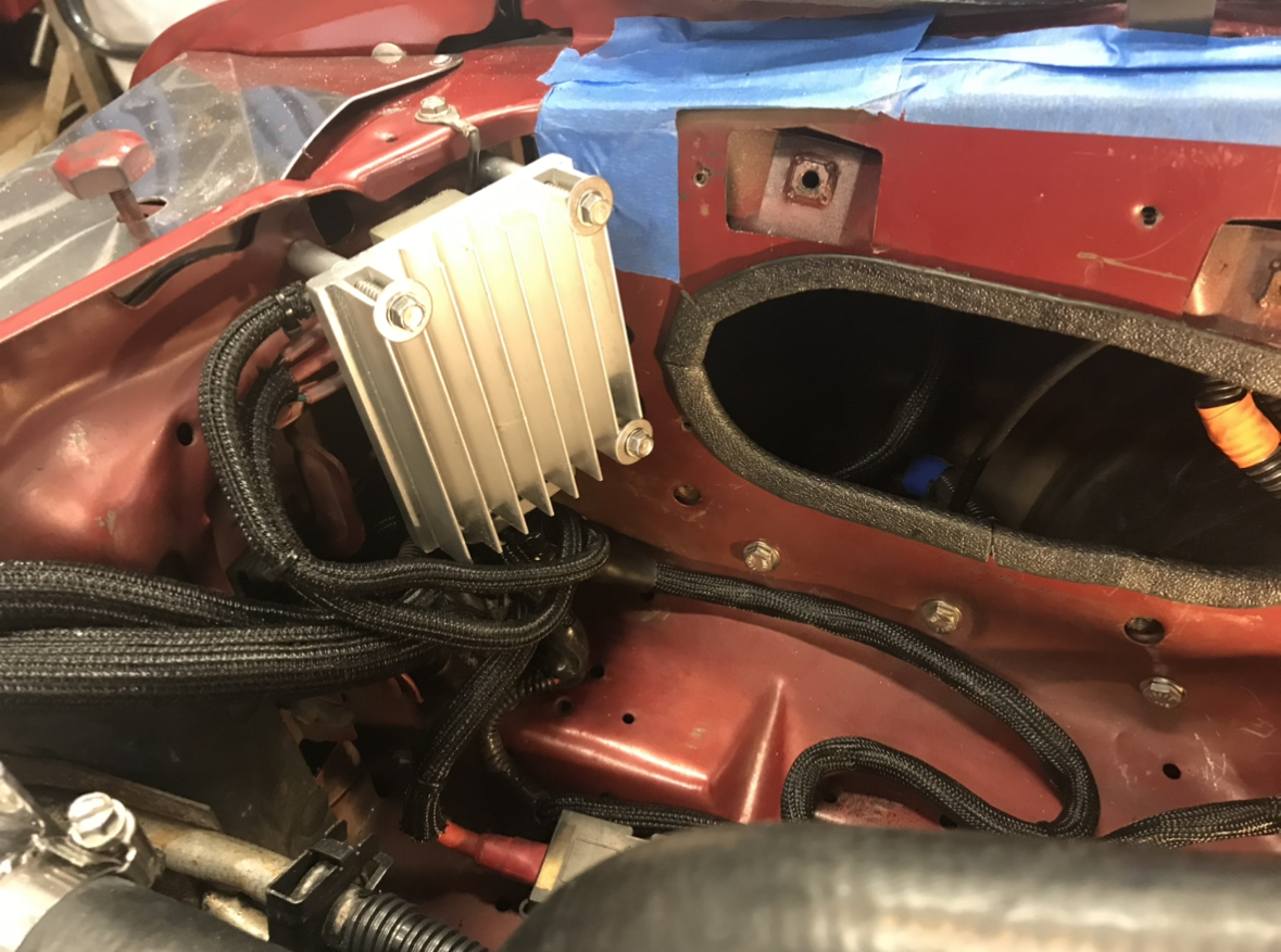

Going to piggy back on this thread as I just finished the MRM Mk3 relocation kit. Have had the kit for a while and figured while I had the car down for a lot of maintenance and installing stuff I have had for years it would get installed as well. I ended up installing it between the core support and the cold air kit pipe where it goes through the inner fender. Made an aluminum bracket to mount the heat sink on and bolted that to the bottom of the front inner fender.
Ended up getting different mounting hardware but used the aluminum spacers provided. Drilled the spacers out to accommodate the 1/4-20 x 2-1/2" stainless steel machine screws with nylock nuts.
Bracket to car mounting hardware are stainless steel hex cap screws with nylock nuts:
Used the hex cap screws included with the kit to mount up my existing TFI module. Used it rather than my new one because I know it works and I do not want to chase myself when I get the car back together and for some reason it does not want to run.
Installed:
Installed:

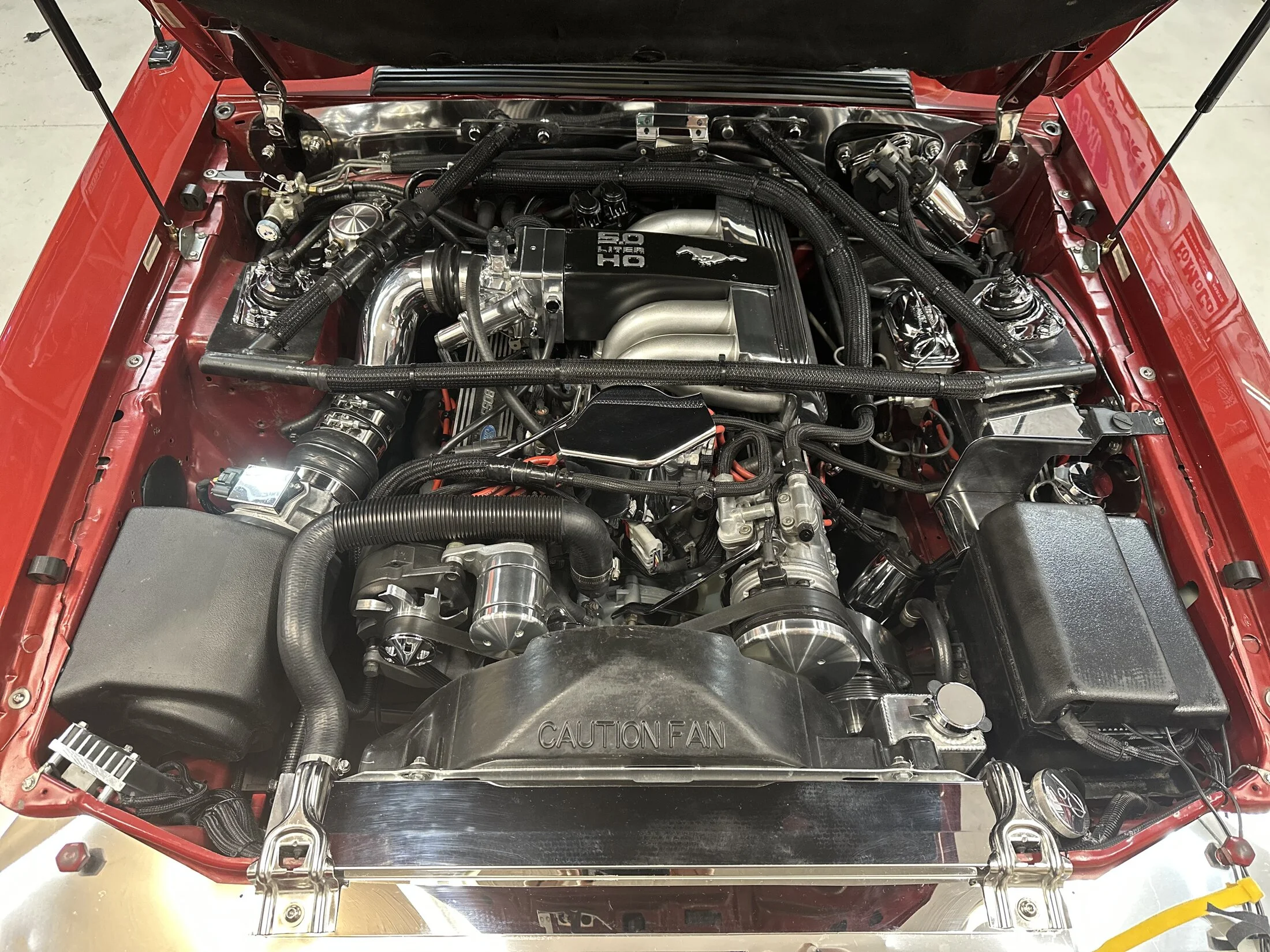

Images of my MRM mk3 install…

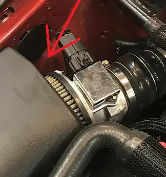

To stay on topic, when I relocated my TFI module I mounted to the side of the fender apron by the mass air meter the temperature of the module was about 100*F after a ride. I moved it to the present location in front of the March airbox when I switched to a Pro-M 77mm mass air meter. I found the new location was consistently 10*F cooler than being mounted on the fender apron by the mass air meter. Not a huge deal, but it was a measurable change in the right direction. Almost any mounting location is an improvement over the 180*F distributor.
