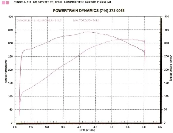

And untill i het the video uploaded and posted...here is the dyno sheet.

Actually your graph looks damn good your Tq is nice and flat, and your Hp climbs very nicely, your seeing at least 300Tq from 2800 all the way to 5500. I would like to see your hp intersect a little sooner in the rpm's and peak a little higher. But IMHO it looks pretty nice, just a bit low. And I assume your air fuel is right around 12- 13 through the entire run.

I like how your torque moves quickly to 300 rwtq below 3000 RPMs and is nice and flat. Though your final numbers may not be what others would expect, my opinion is you have yourself a nice motor there. Good luck with it!
Do I see either your ignition breaking up or a bit of valve float at 5800 up? I had the same thing over 6000 RPMs and my tuner said it was ignition breaking up. Ignition Box would fix that if you don't have that already.
I'd like to see your A/F ratio also. When I had my car tuned the tuner kept the A/F a bit on the richer side and less total timing for a safer tune. The guy who did your motor may have done the same. All Dyno's are different also. Rip it at the track and see what it does.

i would have expected bigger hp #'s also, way bigger. now, im not trying to be a dick here but i cant see spending over $8000 on a motor that makes 12hp more than my 302 vert w/ trickflow h/c/i. unported heads at that. i just don't understand the numbers you guys get. makes me thankfull that i have one of, if not the best, tuners in the country tuning my cars. i understand tuning the car safe, but damn. maybe it's just me.
I understand what you mean...If my car would have had 60-140K i would have just done a H/C/I on it, BUT it had 255k and it was on it's last rod:rlaugh: so i just decided either a brand new car or ressurect the mustang with a new heart which is what i did...the numbers look a little low but at over 100 RWHP than before it justifies my 8-10k spent :nice:
As said above ... tq looks really nice :nice:
Power is done by 5400 ... seems like a bit more should be there :scratch:

Also ... the wavy lines at 5800 ... like was said above
Maybe ... ignition, valves not being contained, even a bit of wheel slip :shrug:
Grady
Steve told me yesterday that i would have benefietd from a Performer RPM II intake, minimal but he said i would have benefited, as for the wavy lines i would suspect the ignition...it is stock except for a MSD blaster coil, FRPP wires, and a MSD dizzy, as for valve float, i hope it isn't so since i invested in the full Ed curtia PS3 valve spring upgrade for a reason.

The numbers through out are way too low. BUT we don't know the total timing or a/f so its tough to say how low they really are.
For all the money invested in this thing you should have went with a custom cam since you already have ed's ps3 spring kit.

Its probably just too conservate of a tune being the culprit. I would however consider investing in a holley intake, custom cam and more gear down the road and really make this thing a 331 ;)
