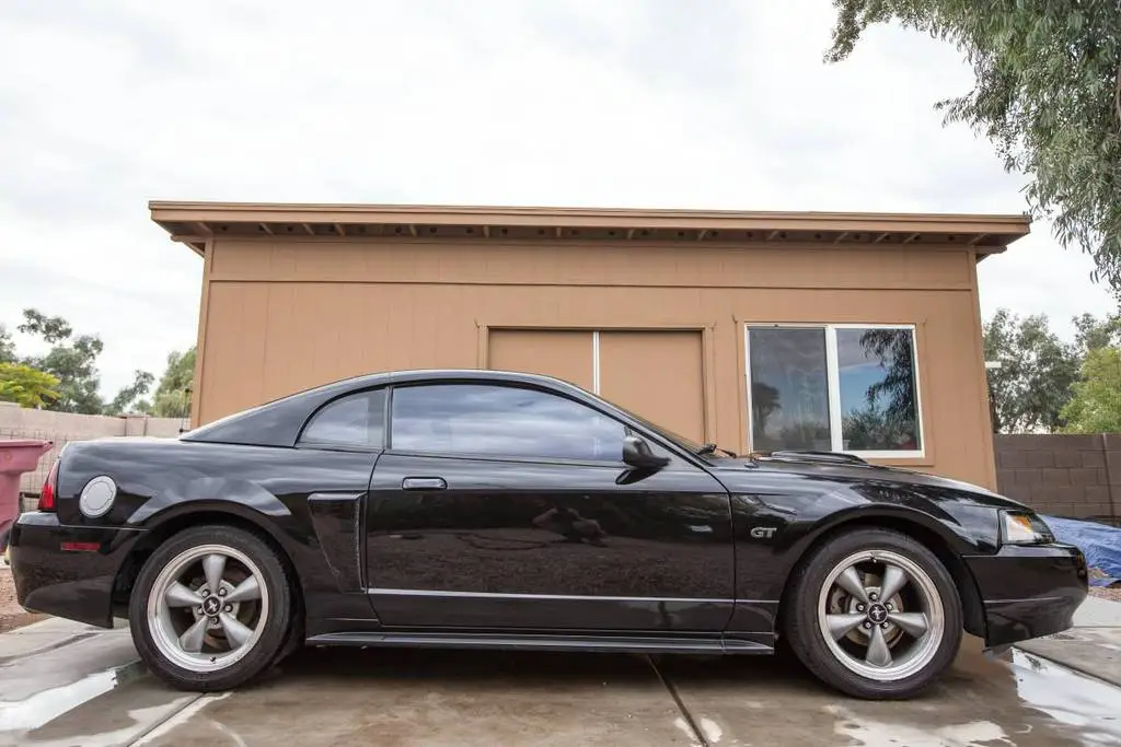

Story time! Let the epic lengthy posts resume. ;)

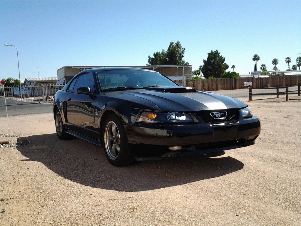

Picked up an '01 Mustang GT last month after being 'Stang-less for a little over a year - the '09 Crown Vic was comfy, but a poor substitute. It was hard to find one that didn't have a metric crap-ton of miles already on it and/or hadn't been modified to death by prior owners, but I did manage to score this one with 121k on the clock and in almost completely factory condition, aside from a terribly cobbled-together and rotten cat-back, a stupid aftermarket alarm system, Eibach springs that lower it just a tad (without caster camber plates, grrrrr), and a couple of minor cosmetic mods. A Carfax revealed that I am the EIGHTH owner of this thing - sheesh - but overall, it's in decent shape:
It originally started out in Tennessee and then came to Arizona sometime around '08 and was apparently very well cared for by all seven prior owners, so there's no rust to speak of underneath. Bought it from a kid in Scottsdale who was selling it because he'd picked up an '03 or '04 Mach 1 (can't remember which year). At some point, someone tried to kinda give it the Bullitt look by deleting the rear wing, filling the holes, repainting the trunk (you can just barely see the fill spots if you look at just the right angle), and adding a few aluminum pieces inside and out (fuel filler door, pedals, mirror/window/lock buttons, shifter ring). Came with the Mach 460 sound system, but of course the factory head unit was starting to crap out, so the prior owner kid had an aftermarket Kenwood head unit swapped in (he did include the original in the trunk, FWIW) - sounds okay at best, but probably going to need to replace the speakers soon. Prior owner kid included receipts for all the stuff he'd had done for maintenance, so most everything seems to be kept up on for the most part.
As cars in Arizona tend to go, the clear coat is making a departure from all horizontal surfaces as quickly as my hair has been disappearing from the top of my head. Prior owner kid covered it up creatively with flat-black Plastidip by adding a Mach 1 type stripe down the middle from the scoop, as well as stripes over the top of the fenders and "hash marks" coming down the sides - very subtle, can't really see it in pics unless you're at the right angle. Clear coat looks horrible on the rear bumper, which also has a bit of a hole in it from where someone backed into something at some point in history. (This is the only pic I have handy at the moment.)

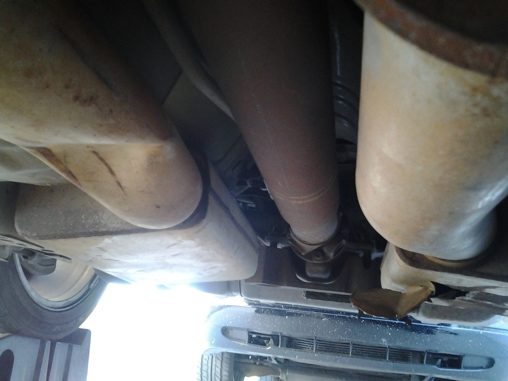

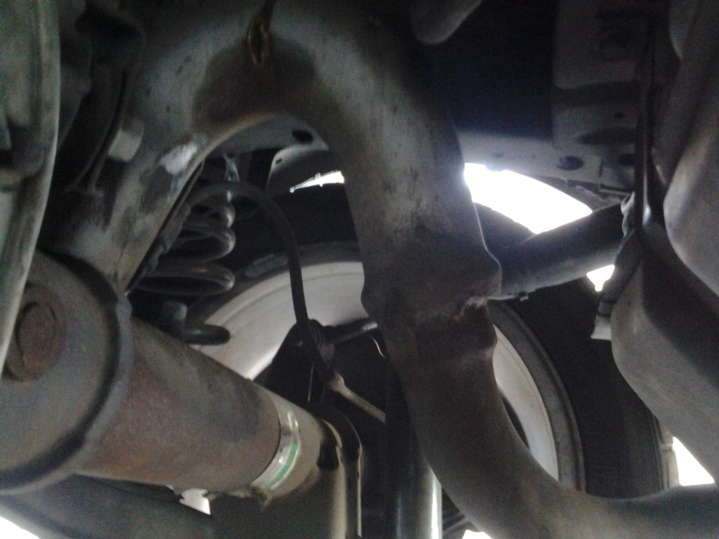

And lastly, the crappy cat-back had a GIANT hole in one muffler where it had rusted/rotted through internally and then blown out, and the passenger-side mid-pipe was pinched almost flat where the kid had backed out of his driveway and dropped it down too quickly over the curb. That and getting the front end properly set up (again, it's lowered without caster camber plates to properly align it) were my immediate concerns. Sooooooo ... that's where I was about two weeks ago. :)
Reactions: DSG_Mach

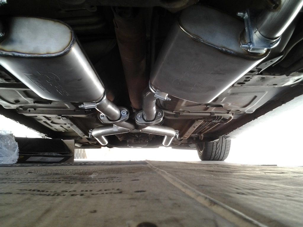

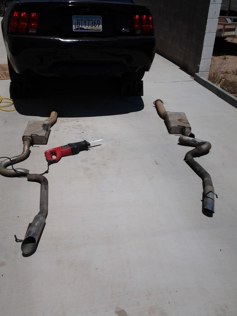

Fixing the exhaust was the #1 priority. With a huge hole in the muffler on one side and the mid-pipe of the other pinched, it was in sort shape, not to mention it was hideously cobbled together by some hillbilly welder. It actually went from a THREE-INCH cat-back (looks like a MAC brand setup) and necked down with a TON of welding to what appeared to be the factory tailpipes. Ugh. Sounded like an old pickup truck and the exhaust fumes were killer ... although some old guy at Wally World complimented me on the sound it made. LOL
I was tempted to go with a Magnaflow cat-back, but I remembered hearing lots of gripes about droning, so I went with what I've had in the past on "teh Notch" ('89 notchback) that I had lots of fond memories of: PYPES. Ordered "The Beast" system, which cost less for the O/R X-pipe and cat-back together than Magnaflow wanted for just the cat-back. Arrived promptly, and as soon as I had a weekend free, I busted out with the Sawzall and had at it:
Lemme tell ya', installing this cat-back on ramps was a NIGHTMARE. Ugh. The X-pipe went on without any fitment problems at all, although I did need to buy a new passenger-side manifold flange gasket because the system didn't include one (instructions say to reuse your original, yeah right :rolleyes: ). But getting those tailpipes over the rear axle SUCKED. Wound up having to jack the car up in addition to it being on ramps to get enough clearance to mostly get it fandangled in there, and even then I had to bend the hangers slightly to squeeze them past the upper control arms and then bend them back into position once it was over there. The driver's side lined up in a jiffy once the tailpipe was in place; the passenger side took me no less than TWO HOURS of fartin' around to get it to line up in such a way that it wasn't hanging way down and wasn't rubbing/bumping against anything. In hindsight, I'm kinda wishing I had instead gone with the SLP Loudmouth II system; I had the LM1 on my '96 GT and the install was a dream because the tailpipes were multi-piece deals that went in easy and allowed for all kinds of adjustment, whereas Pypes uses one-piece tails that suck to fit. Anyway, here's the final result:
As expected, it is freaking LOUD, even more so initially because I had to do some turning and adjusting to get those two front clamps on the X-pipe to seal up (HUGE leaks on both sides initially). Already, I'm thinking I need some cats on this thing because it gets pretty raspy on the top-end. It's plenty civil, though, as long as you don't give it anything near half-throttle and keep it below 2k RPM - anything more than that, and it'll likely raise eyebrows of the po-po. :) Minimal drone on the highway, though, and the overall tone is very nice - deep and throaty but smooth.
