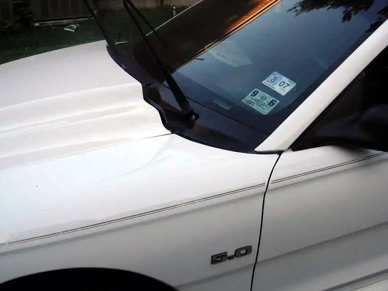

Anybody know what its called? Mine looks kind of old and i was thinking about taking it off and painting it.
That being said, anybody know how to get it off? I'm also wanting to paint my mirrors too. Basically any exterior plastic on the car seems to be fading.
picture for clarity:

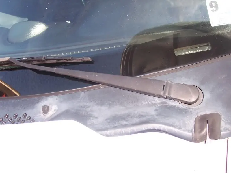

Mr clean magic eraser works well.
Before
After

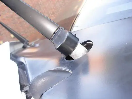

Alright, even though I said I was going to get one of the two former mentioned applications I decided to change my mind and just use what I had in my garage.
I used some f21 from turtle wax (circled in red) which i usually use on my interior and i finished it up with some turtle wax polishing compound (circled in green) which put a nice smooth and equal dark hue everything.
Ok, again, heres my Before:
and some after shots:
I think it worked out really well. What do y'all think?
