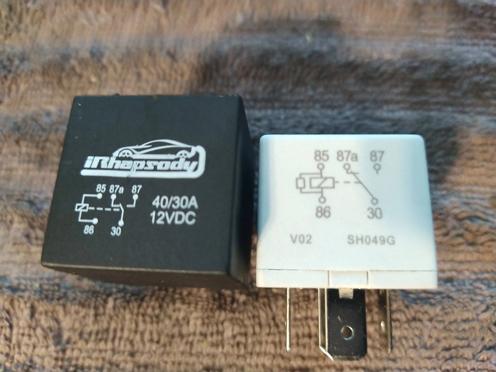

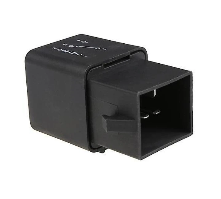

I'd try replacing the EEC and Fuelpump relays and looking at the EEC grounding points. If you get new relays get ones w/diode protection.. These are Bosch style but Ford started putting diodes in their relays starting in 1995 in the pic below it.

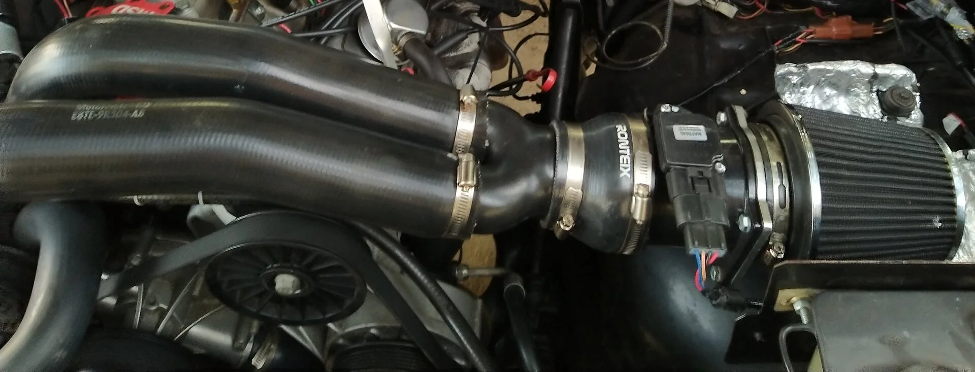

Mine was doing something similar to what you described and happened a couple of times in separate situations.
The very first time it happened it was the adapter that adapts a 4 wire MAF to a 6 Wire..One of the wires wasnt getting a good connection inside the plug so I tightened up the female ends and put some di-electric grease on the plug to seal it.
When it happened again and I checked the plug it was good then someone suggested putting a plate so the highway air doesnt mess with the MAF...
So it turned out that my MAF sensor was getting an extra blast of air being unshrouded and that extra burst was enough to make the engine cut out then come back when it cooled the heated wire down too much...
It gave a lurch jerk like I had a leaky sparkwire..The rpm's would spike up kinda too when it was in no-mans land..
Another thing to note is that none of the problems threw a code either...
I put an aluminum blocker plate and haven't had an issue since.........
Good Luck
Good Luck

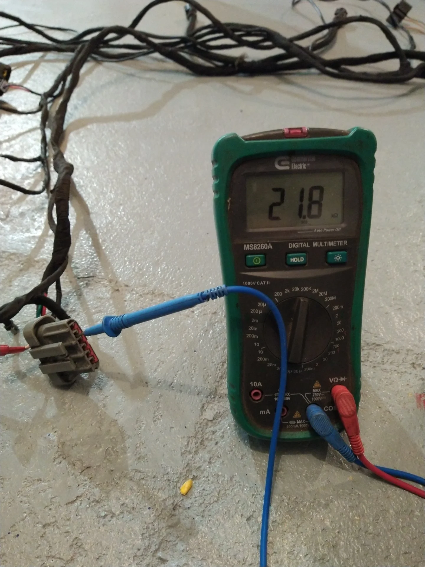

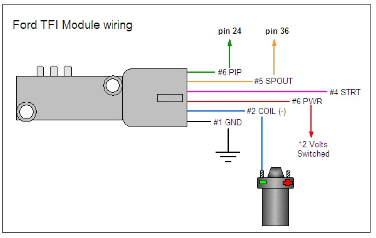

One thing to check is the resistance on the IDM circuit wire...If you get 0.00 and have a manual trans w/ non ccd TFI you need to install a 22kohm resistor on the wire coming from pin #4 on the ECU plug to pin #2 on the TFI plug and the negative side of the coil too...

What most dont know is that automatic trans cars give signals to the ECU through the IDM circuit and the TFI has a Computer Controlled Dwell andalso built into the CCD type TFI module is the 22kohm resistor.
If you try running CCD TFI on a stickshift conversion things get wacky usually after 30-60 mins of cruising as the computer cant adjust dwell..
If you try running CCD TFI on a stickshift conversion things get wacky usually after 30-60 mins of cruising as the computer cant adjust dwell and if you dont have the 22k resistor wired in by the ECU connector coming from pin#4 you'll get sensor signal problems...
