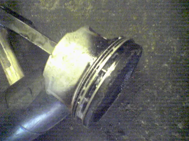

The rebuild had finally started.. here's a pic of one out of 3 of my stock pistons.. looks healthy huh? I can't believe how week these things feel compared to their forged counterparts!

yea im glad it was something worth doing the build for tho.. i'd say 3 cracked pistons is worth it!
Yea the difference is night and day between the stock and forged pieces!
