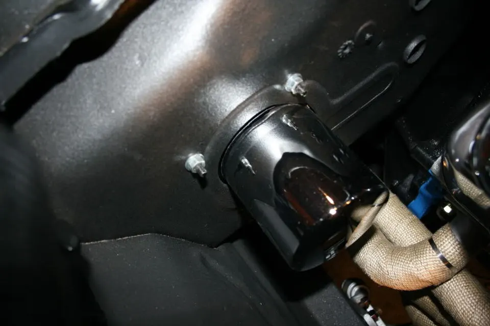

I like that idea... intuitive. Does the filter cover just slid on? How is it secured?

The blower motor cover was trimmed using a pair of metal sheers and I used back sealent to mount it. Just loaded it up and squished it on. I setup a bracket to hold it while it cured. I can knock it off with a hammer if I need to get the heater box out and for $10 I wont mind damaging it.
