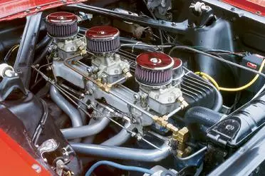

Here's a link I found the other night about a built I6, he switched over to the 5 lug also like crane550 wants to do.
http://www.mustangandfords.com/featuredvehicles/56439_66_mustang_coupe_inline_6/photo_03.html
Here's a pic of the I6 tri power settup w/ the headers.
