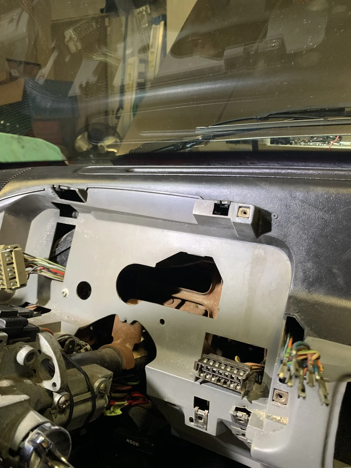

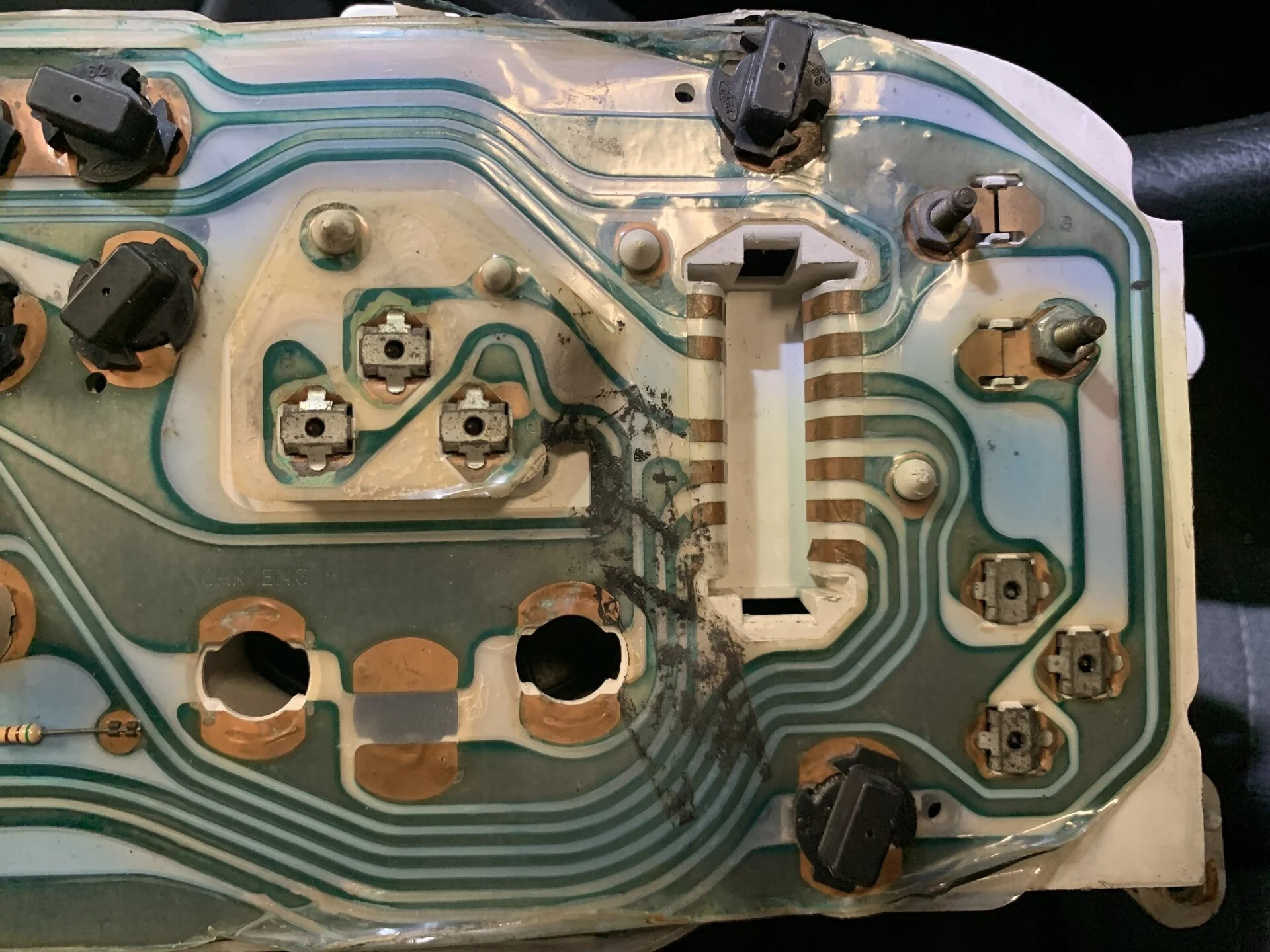

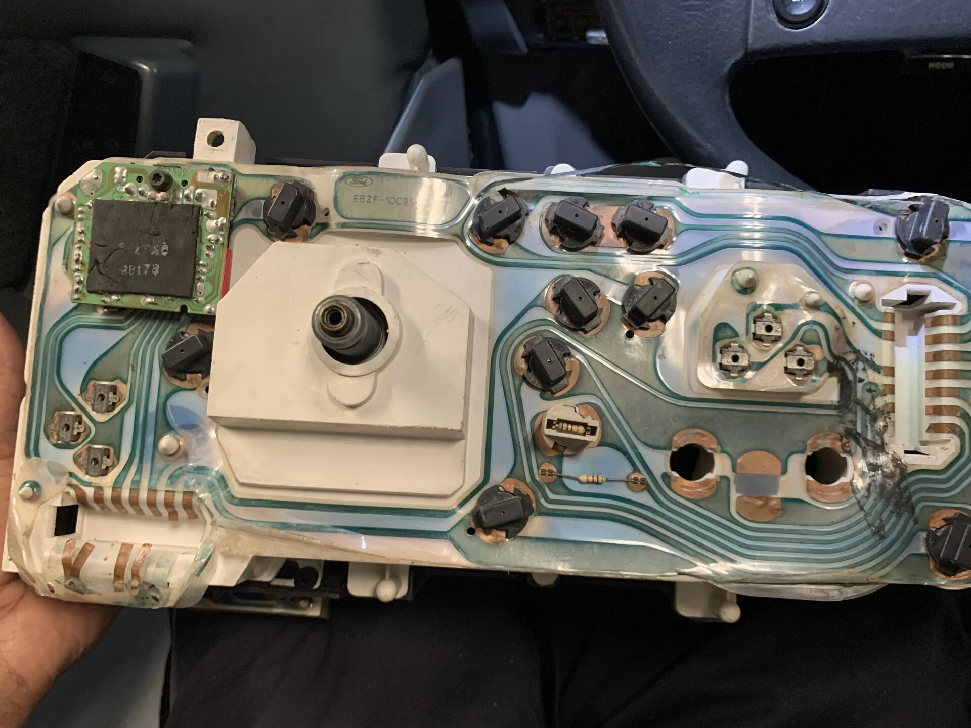

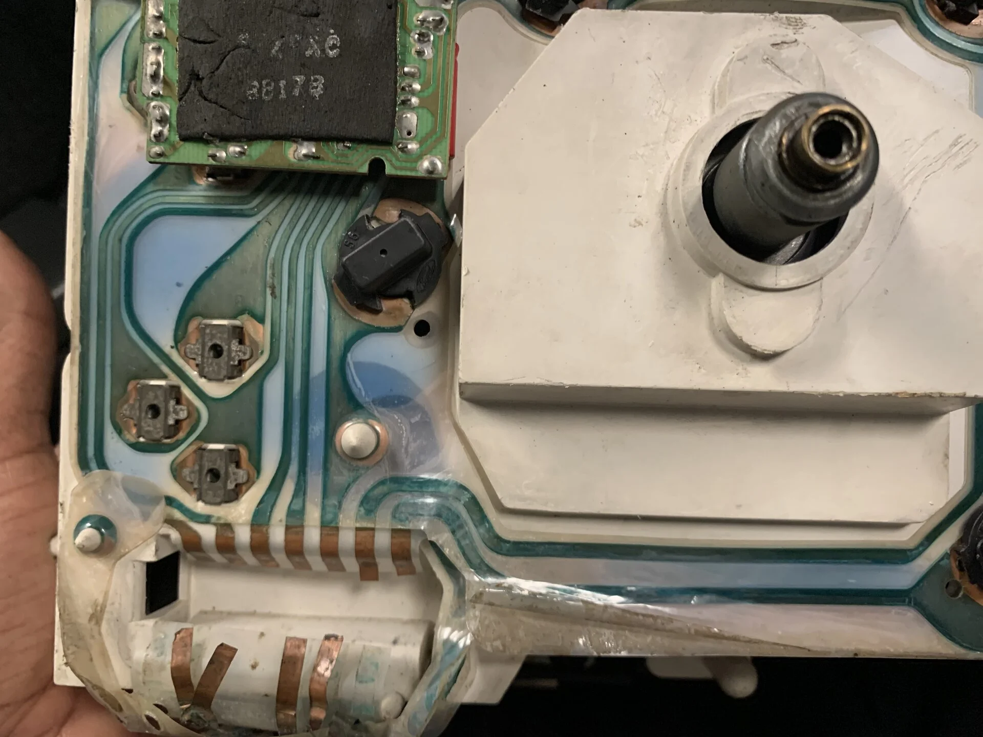

I appreciate it guys, I went ahead and took the cluster out to see If anything was disconnected or tingle up, so far the only thing I see is my # 13 fuse (5amp) keeps blowing out as I just replaced it a second ago and the back of the cluster looks a little haggard, don’t know if that would stop it completely.

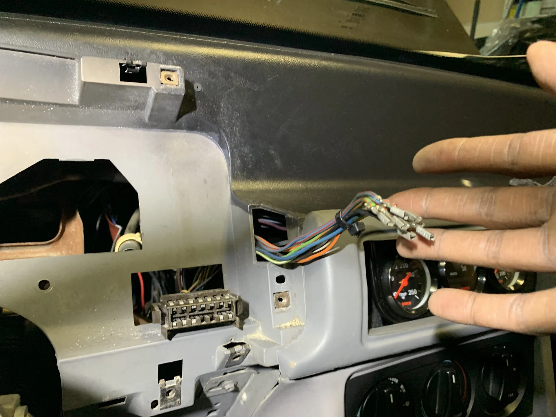

That gauge cluster printed circuit has several broken and 1 missing trace. They do sell a reproduction printed circuit. The hazard light harness needs to be put back in the plug. That'll cause issues with wires touching each other. If you tape them up individually we can walk you through re-pinning another connector.
Reactions: SSnakeGT127
Yeah I was looking at the printed circuit broads at NPD, which I'm probably going to order from, as well as a hazard switch pigtail from LMR, ( The old one literally broken apart a couple years back) and somehow I repin them to make the flasher/ turn signals come back on,
So overall, I had a few things to tackle, including this and some others stuff non-related, not nothing too crazy.
Reactions: 90sickfox
I'd get a new hazard connector for sure and repair the circuit traces on the back of the cluster. Make sure nothing is touching in the mean time and hook it back up one connection at a time and see if the fuse blows. If not then you know the problem was in the cluster with a touching trace. If it does you have a starting point to trace back.
