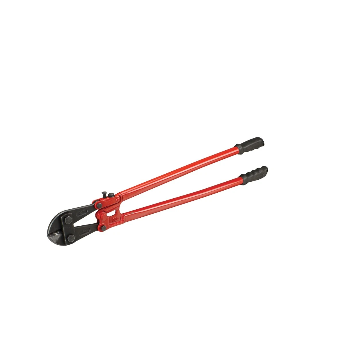

Commonly used for locking people out of their rental sheds. Main idea is that the barrel of the locking slide needs to be protected where a pair of bolt cutters can not get a bite on it. You could get creative and drill a hole in the box itself where this would fit in another location other than where the one you have on it now.
