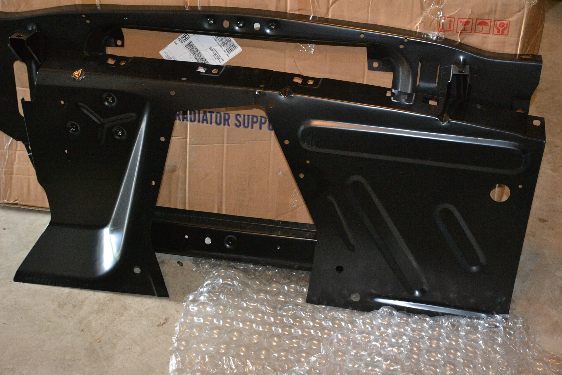

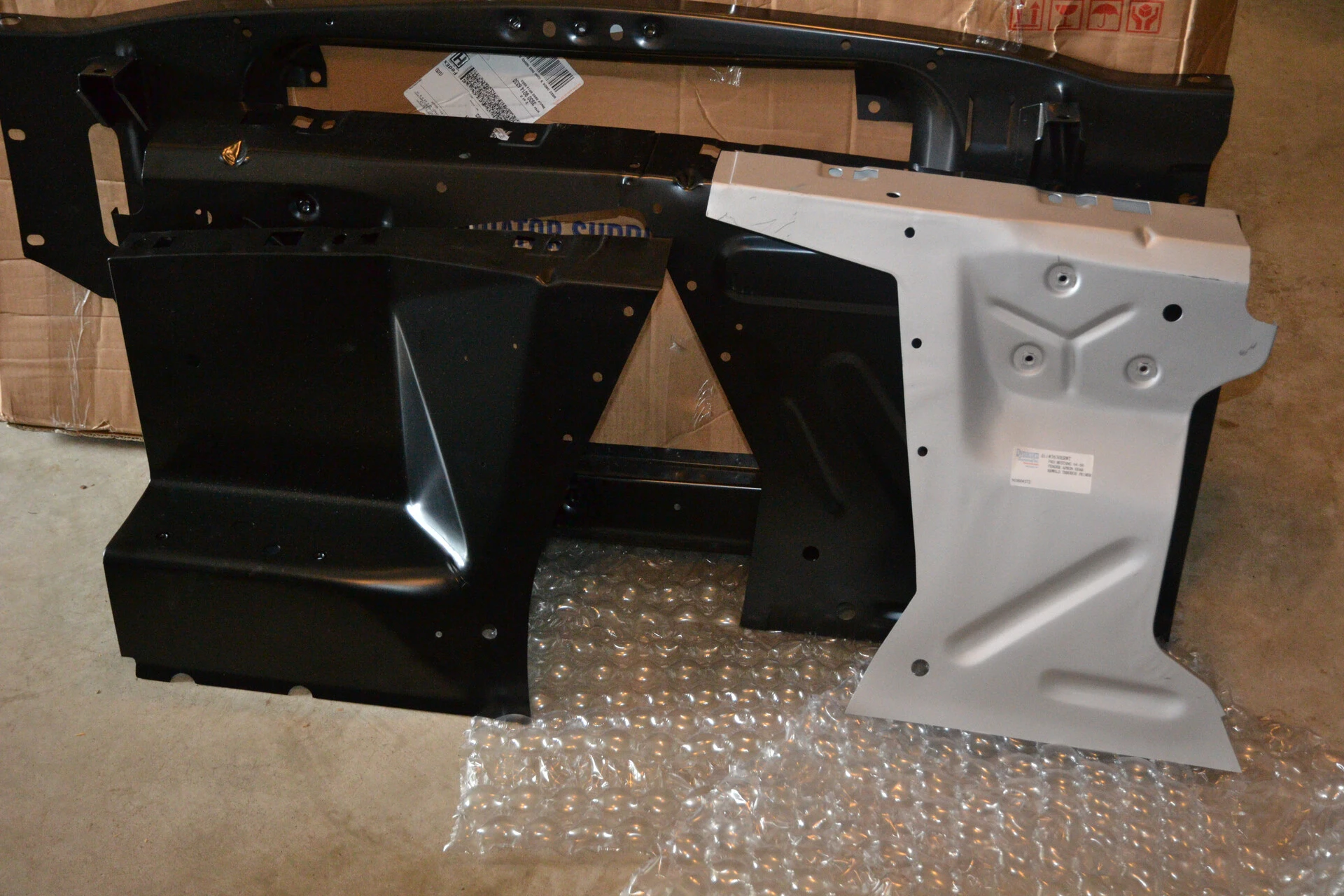

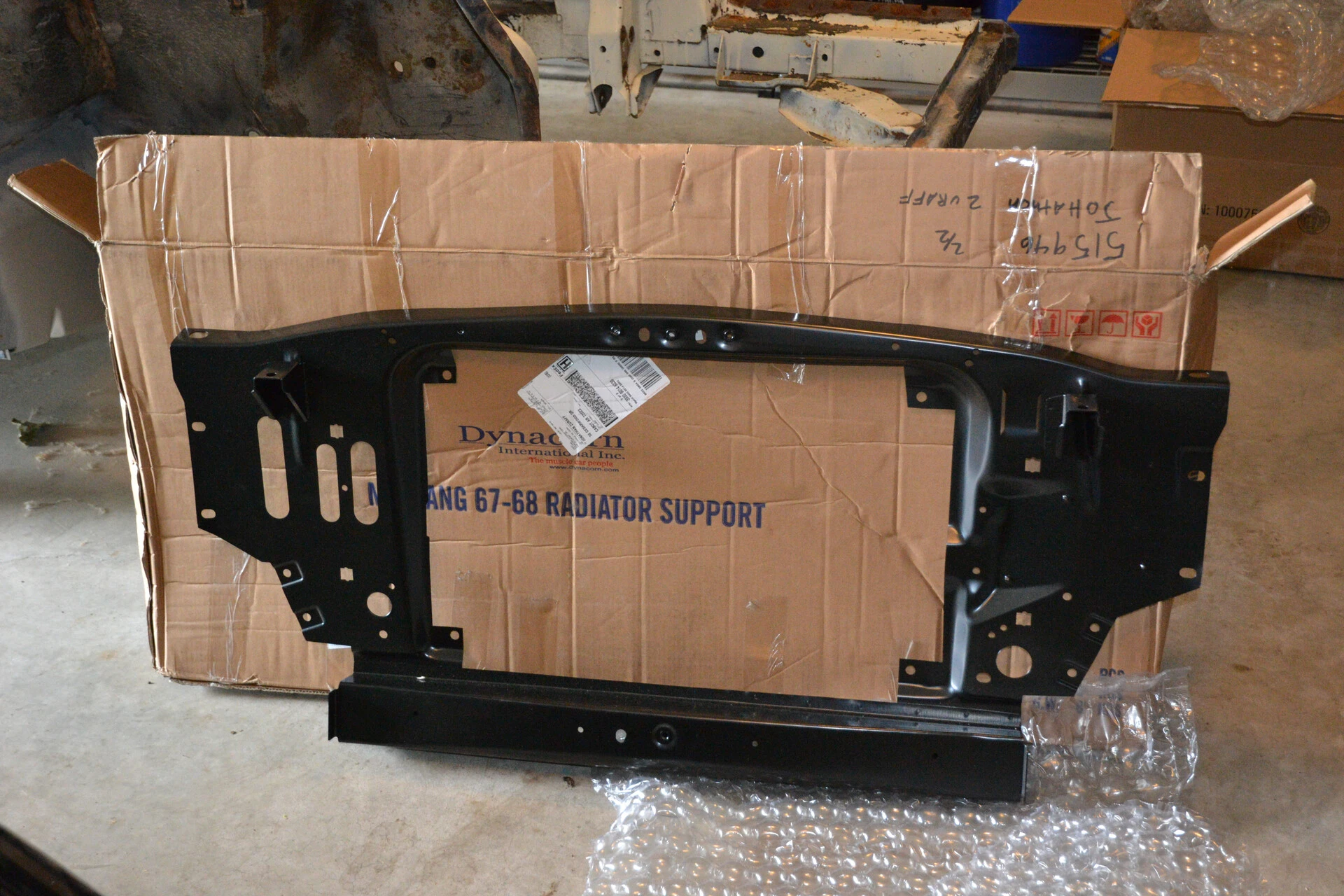

It was. My main concern with this one in addition to the waviness is how soft the bends are. It's a mushy stamping.
My experience so far has been that Dynacorn parts are typically much better stamped. Sometimes I'll order the CJ Classics branded parts since they're sometimes be Dynacorn parts. It's hit or miss. When I did torque boxes, I ordered the '67-'68 Dynacorn pieces that weren't welded together. They screwed up and sent me a '69-'70 set that had the parking break pass-through on the driver's side. It still fit just fine.
Yeah...CJs parts are all over the place...like you said, the classics line is often Dynacorn...I know the strut rod braces I bought were(those are actually better than the original for strength), as well as a lot of misc panels. It is rather baffling since my radiator support was so much better quality. They must have swapped suppliers in the last 6 months or so for the rad support. Time to go to NPD I guess, at least with NPD you can get better info on the supplier.
