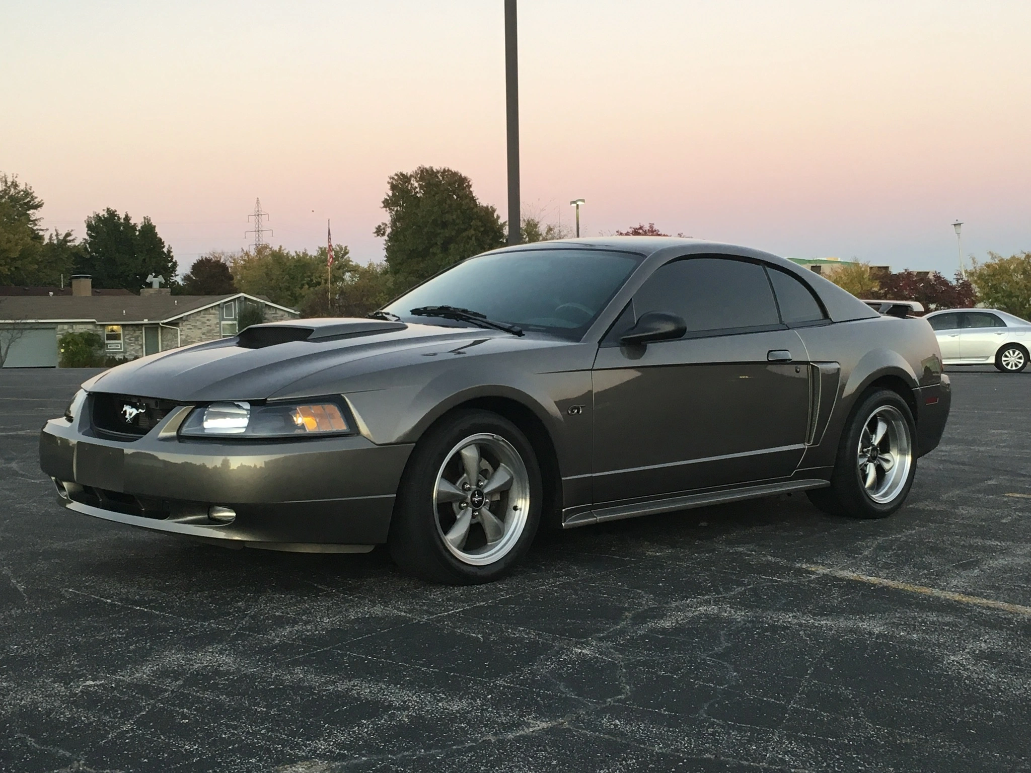

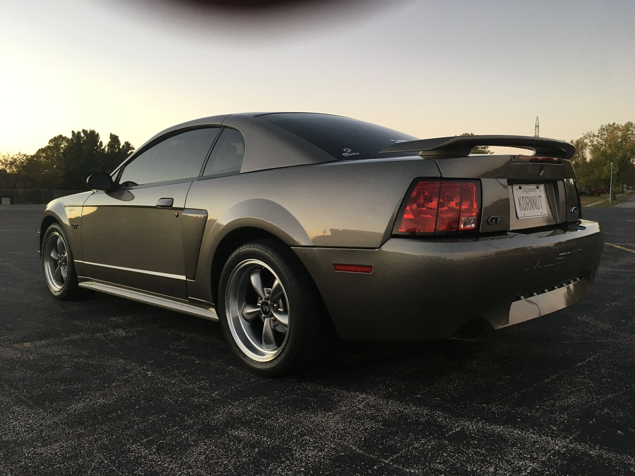

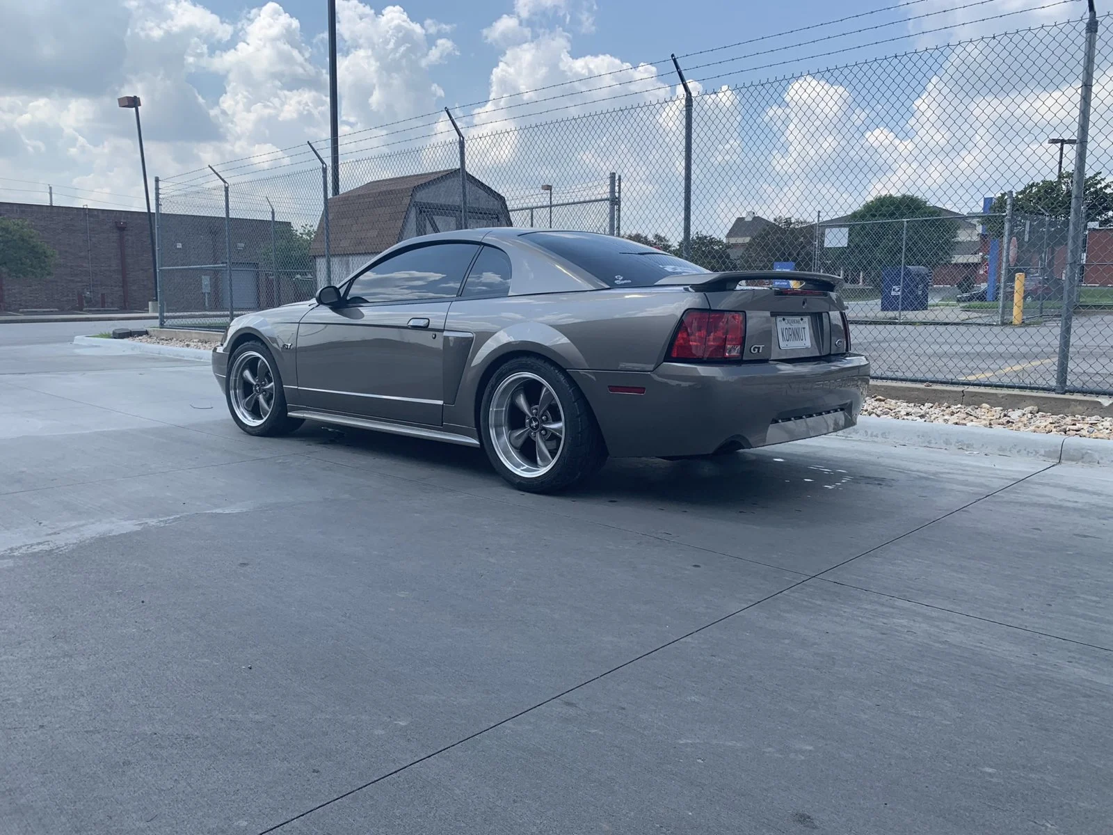

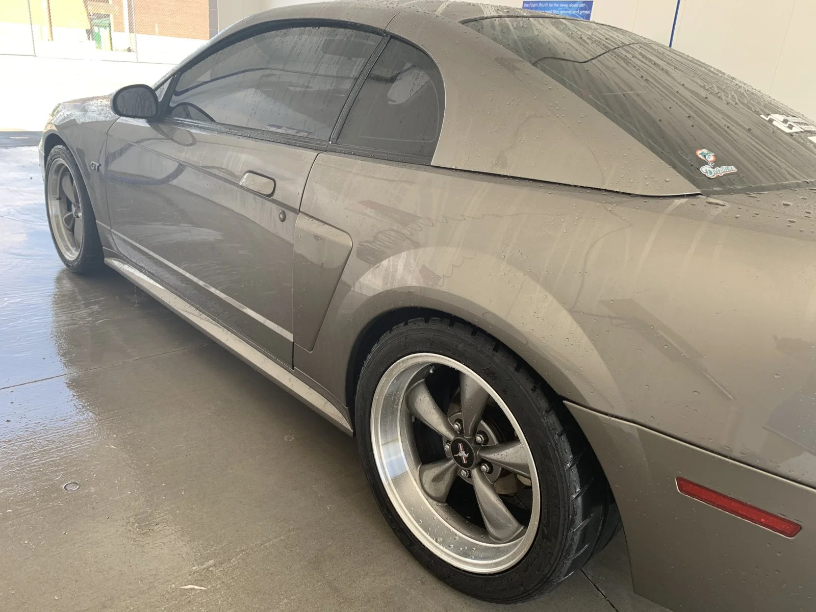

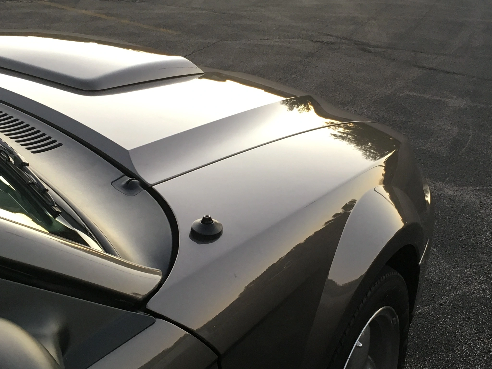

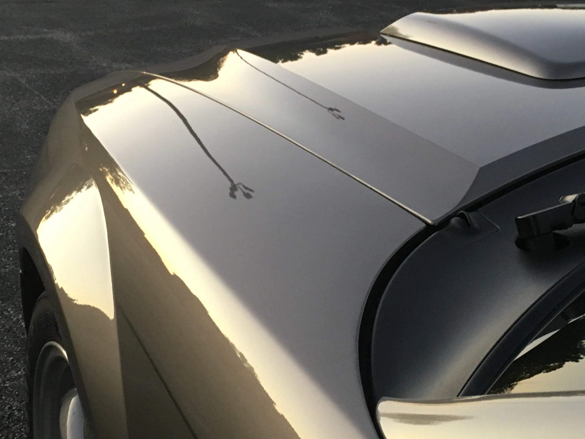

It’s been a few years. All I’ve managed to get on the car is new shift boot, e-brake boot, 18 inch bullitts and tires. I have thought a lot about selling the car. I won’t get anything really for it(sub 10 grand). I have no use for it these days. Maybe I will get back into it one day.
